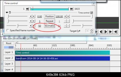

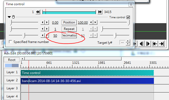

  17. Probably racer-x does not aware of this in AviUtl yet:
    The Time Control object is under the New media object menu.
    Decimation value as a percentage.
