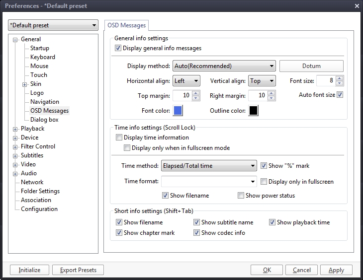

  3. Maybe 'Scroll Lock' or right-click 'Config/Lang/Other' and 'Display Playback Time Info on Screen'.
    More settings (in this case 'Time info settings (Scroll Lock)' ):

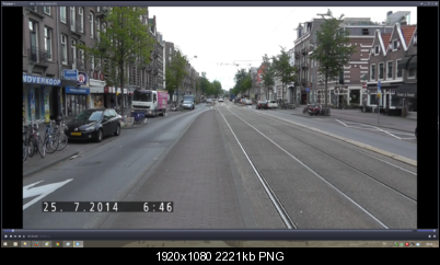

    Here's a screenshot of the on-screen info I am talking about:

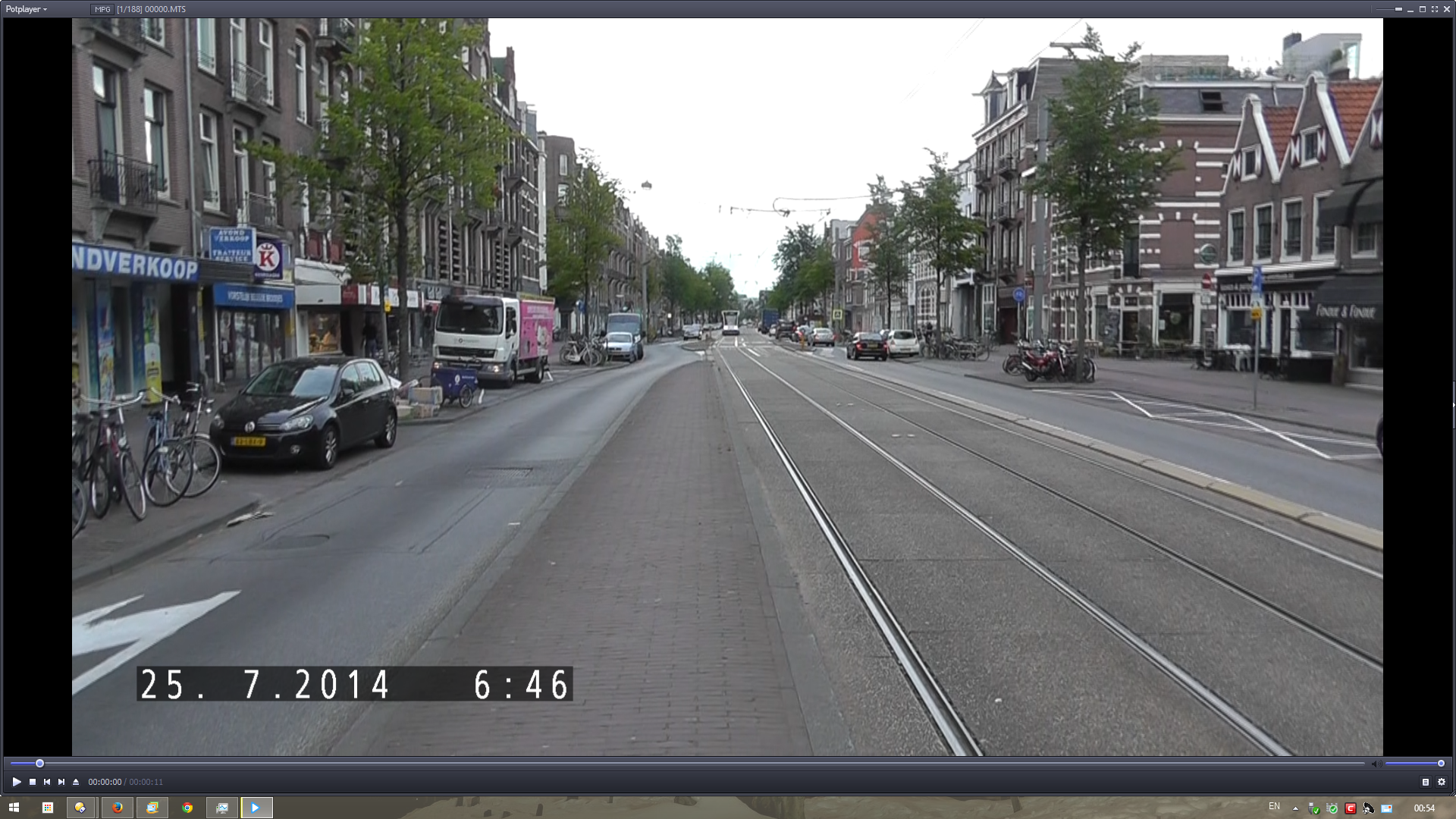

    "subtitles"...it's not hard to do - it just isn't remotely intuitive. I completely appreciate this confusing the OP - I've had the same issue of the date and timecode being stuck on top of some videos and not others - mainly on .mts files for some reason, and I don't consider this 'subtitles'
    Subtitles are basically Closed captions. date + time is superimposed metadata, subtitles are a subset of that - and much, much more importantly - the majority of people wouldn't understand date + time to be "subtitles" so that's why there's loads of us struggling searching through the endless menus of Potplayer trying to find where to turn this random weird thing off which none of us asked to have superimposed on our video and 99% of us don't want turned on my default.
