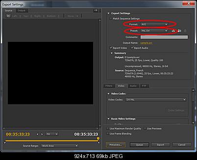

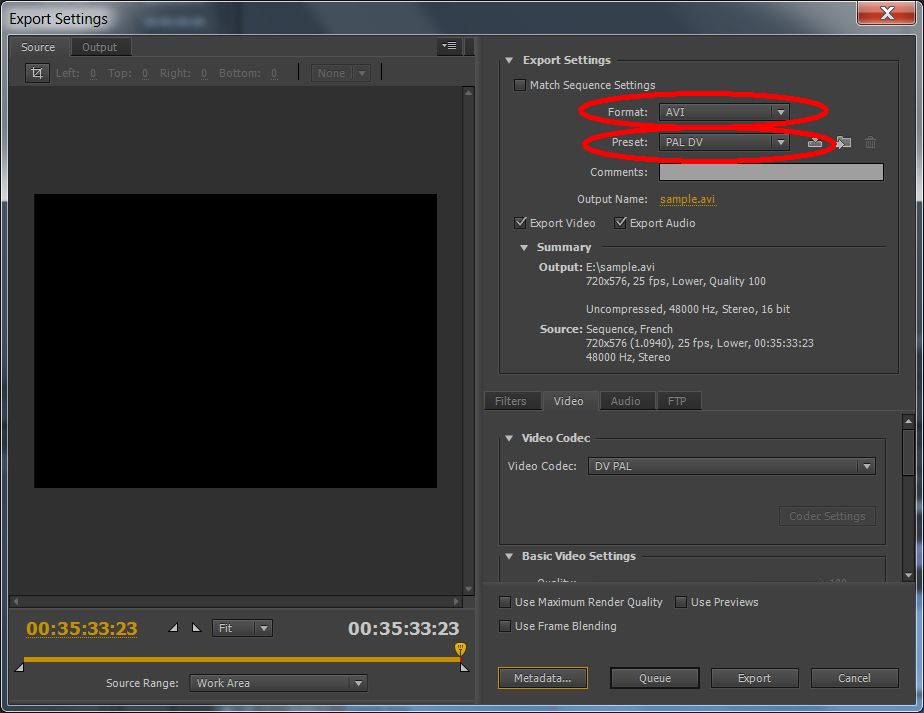

  8. select timeline
    then File -> Export -> Media :
    In format select Microsoft AVI or AVI
