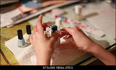

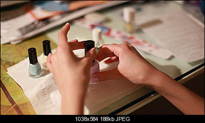

    There are a few dots of pixelation here and there... only lasts for 1-3 frames. Much like weak signal reception on digital TV.
Name:	Fullscreen capture 90214 52348 PM.bmp.jpg
ID:	27246Click image for larger version
Name:	Fullscreen capture 90214 52353 PM.bmp.jpg
    Aug 2014
    Canada
    It is completely gone when I switch back to QTinput.
  22. Is it reproducible (does defect always occur on same frame), even when you seek & go back? Or are defects random?
    Can you post a native MOV video sample (cut a segment around that defect)

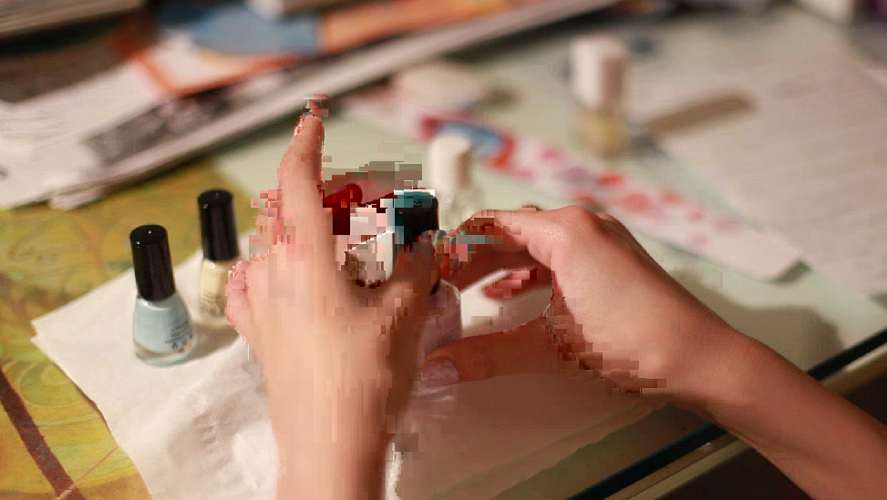

    So I tried direct stream copy in virtualdub for the previous clip (no avisynth) and produced a .avi file. Then read that .avi file in avisynth using FFMS2 source in avisynth. The artifact went away!! It appears FFMS2 likes .avi more than .mov!
    So I found another short raw .mov clip directly out of 5Dmkii and the problem is again happening on frame 82-85 or so. It is about 80% reproducible in Avspmod using FFMS2 V2.2 source in avisynth. It is now attached. (QTsource doesn't have this problem) Thanks!
  28. I can't reproduce any errors , but I'm using avisynth 2.6 with FFMS2 r931
    http://forum.doom9.org/showthread.php?p=1688624#post1688624
    First try this
    Delete the index and try
    FFVideoSource("MVI_6235.MOV", threads=1)
    If that doesn't work , you can try avisynth 2.6 , with the FFMS2 C Plugin

  30. It doesn't make sense, because they are both using the same thing, FFVideoSource(). Something else is going on
    FFMpegSource2 is just a wrapper function that includes audio with FFAudioSource if you use atrack=-1
    ie.
    FFMpegSource2("video.mov", atrack=-1)
    is the same thing as
    aud=FFAudioSource("video.mov")
    vid=FFVideoSource("video.mov")
    AudioDub(vid,aud)
    What I suggested was use threads=1, because sometimes seeking can be problematic with mulithreads under some situations (shouldn't be with these files, other files like AVC transport streams with B-frames)
