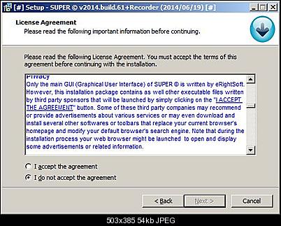

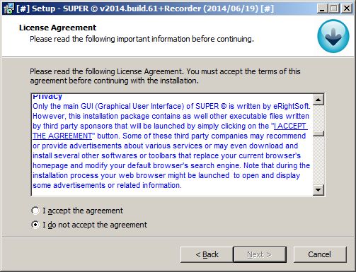

    Might be this horror.
    At least they warn you that if you are daft enough to accept it you will be infested.

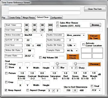

    Do you have a short video you can post to try it in an improved version utility? I have had great success using YAMDi , FLVMDI, FLV Meta, and FLVMeta built into it and very rarely have to do a hex edit to fix.
    Name:  ScreenHunter_82 Aug. 25 11.46.jpg
Size:  41.1 KBName:  ScreenHunter_81 Aug. 25 11.46.jpg
