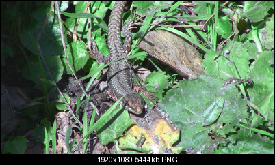

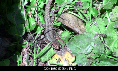

    I used potplayer as video player. See the difference of colors. Why does OPENGL looks better?
    Watch the two uploaded png images:
    OPENGL:

    EVR:

    Assuming all other things in the render are equal (which I truthfully cannot do, not knowing fully the render/playback chain), it looks to be a matter of the difference between OPENGL using the full RGB 0-255 contrast levels vs. EVR using a restricted contrast level. Neither is necessarily WRONG, depending on other factors (display device used, etc). SHOULD it be doing this? - Can't say without knowing further your setup.
    But most people, without other cues as to differences in setup, would say that the higher contrast one is the better one.

  3. The OGL image has blown out brights and other shots probably have crushed blacks. Also, one of the images is being converted with the wrong colors (rec.601 vs. rec.709). I suspect the EVR image is the correctly displayed one. You'd have to upload a short segment of the source to say for sure. Is it MJPEG?

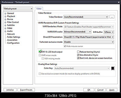

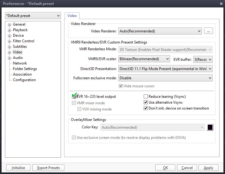

  4. The difference simply comes from a different level. Enabling the following option will make no difference in EVR.
    It can be done using a pixel shader or a built-in video processing filter too.

    No, there's also the 601/709 color decoding problem. One of them is wrong.
  6. I tested it. OpenGL renderer seems to be broken.
