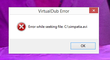

    in virtualdub the simpatia.avi is loaded but when I try to process it or if I play it, I get the error:

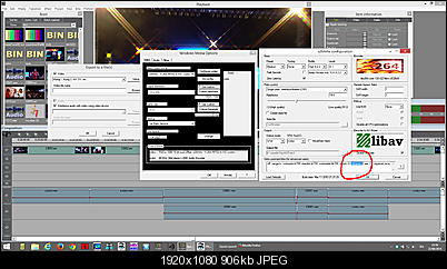

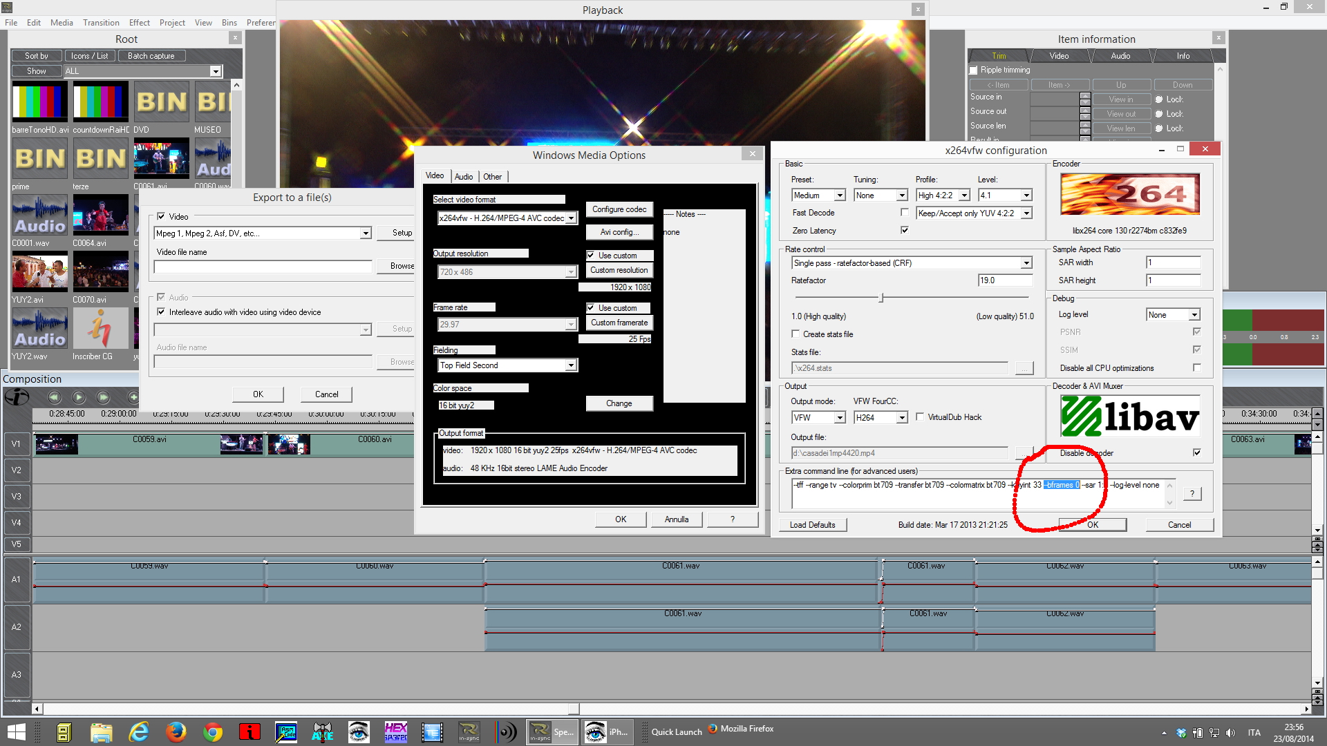

  4. I note this:
    if I use --bframes 0 instead of --bframes 1 in the x264VFW control panel, and in virtualdub all seems well

  6. As far as I am concerned, x264VFW have a bug when used in different mode than "--bframes 0" and out of virtualdub
    So the problem is x264vfw: I realized this only now
    I push speedrazor? wow it's only for cats^^, speedrazor dead 11 year ago
    In attachement the same file but encoded with the "--bframes 0" option: it works fine in all enviroments
