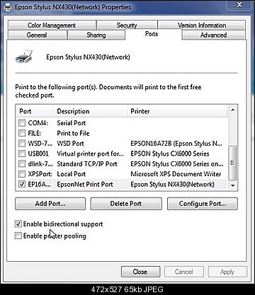

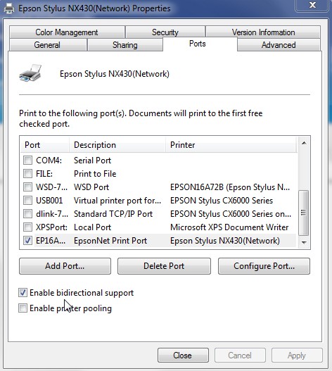

  14. Member Budman1's Avatar
    Jul 2012
    NORTHWEST ILLINOIS, USA
    Had a similar problem and it was caused by not letting my computer know the print was finished. Got to the printer properties and make sure the bi-directional box is checked. Fixed my problem.

  15. Budman, the enable bidrectional support is already checked.
