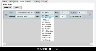

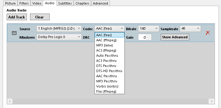

  3. I know that Handbrake supports pass-through, but I can't find which is for mp2.
    Which one from the Codec list should I use?

  4. Try Auto Passthru
  5. Auto Passthru is encoding the audio to AAC.
  6. You could always replace the audio later using MKVMerge GUI.
