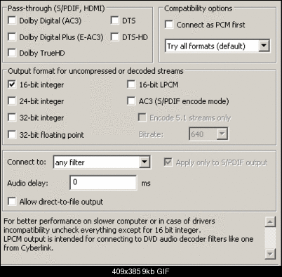

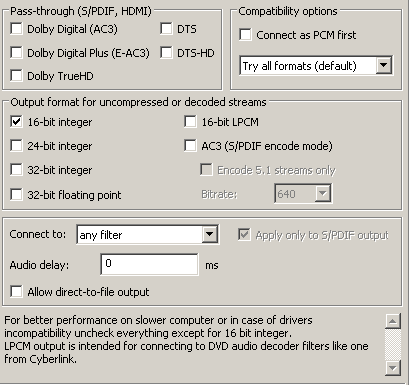

    You could use a player such as MPC-HC with ffdshow for audio decoding, and ffdshow is pretty configurable regarding the audio output. For selected audio types it'll output the raw audio (bitstream) and for the rest it'll re-encode it as AC3. It also has an option to only re-encode 5.1ch audio as AC3 which seems logical if the info I found regarding your Logitech unit is correct. It only supports stereo PCM (maybe that's typical) so I'd guess for stereo audio ffdshow could simply decode it and output PCM, whereas for 5.1ch AAC it'd need to re-encode it as 5.1ch AC3 or you'd only have stereo.
    AC3Filter could be used as an ffdshow alternative. Once again though, a DirectShow player such as MPC-HC would be required.
    ReClock has a similar option for re-encoding audio as AC3.... all audio or just multichannel. DirectShow again....
    LAV filters (which MPC-HC uses internally for audio decoding) seems to have all the same output options as ffdshow except for the ability to re-encode as AC3 on the fly.... as best as I can tell. Or LAV's a.... errrr..... DirectShow filter.
    This is what ffdshow's audio output options look like.

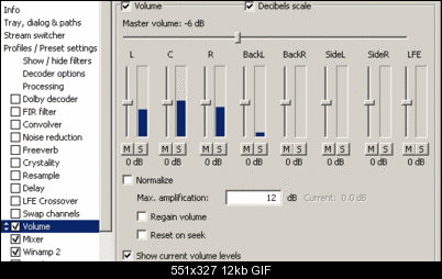

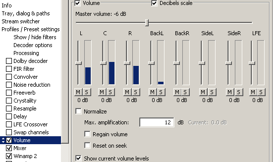

    You could probably work it out easily enough with any old multi-channel audio. As long as you can decode it with something which shows you the levels. Something which lets you mute or solo them in real time would be even better. It'd be fairly easy to check the centre channel is still in the centre and left is left and right is right etc. I can't remember, but have I mentioned ffdshow?

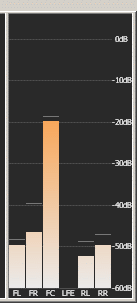

    Or does VLC have an output meter similar to foobar2000?
    Or there's Audacity. To import AAC you need a plugin. Audacity should show you where to download it. As Audacity decodes the audio when importing it, I assume the imported audio always uses the same channel order regardless of the input format (it's re-mapped when necessary).
