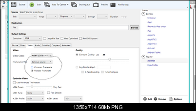

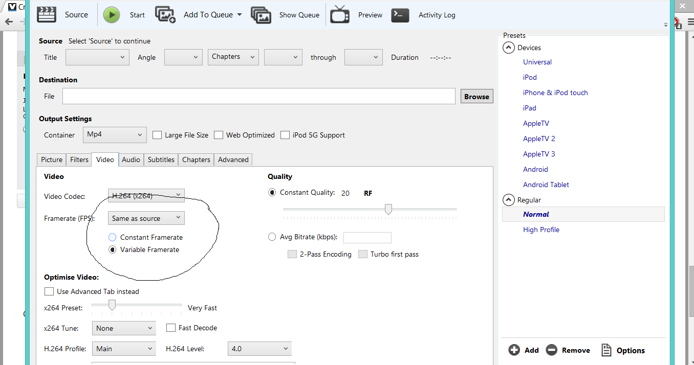

  7. I also think that could be variable fps ( change it in handbrake picture )Click image for larger version
