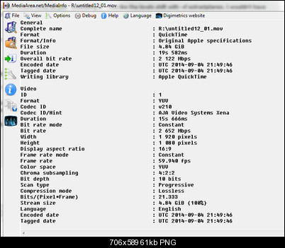

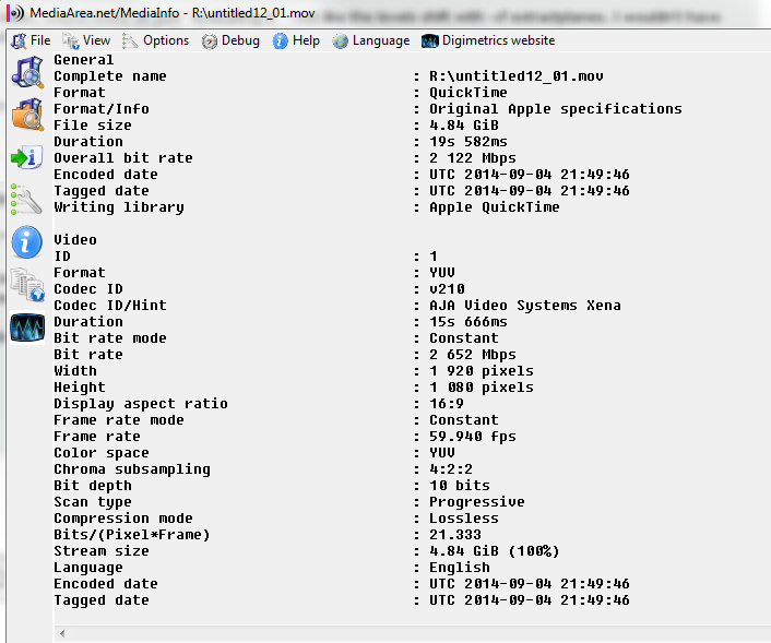

    I also realized that I have *.mov files in the mix. AJA MOV files which are 10-bit uncompressed v210.
    I only have the option to capture in this format given the software application from AJA Systems. I also have AVI files with the same codec. I guess the container is different.
    Would the same commands work with ffmpeg with *.mov files to yield similar expected results?
    Thanks again.

  11. Originally Posted by lotus5 View Post
    Thank you for the explanation. I will dig in a little more as per your suggestions and try these out.
    Yes, same thing. v210 is uncompressed 10bit 422 video, regardless of how it's "packaged"
    AVI and MOV are just "containers". You can swap between them without any loss with v210. It's like taking a "shoe" out of "box" and putting that same "shoe" into another "box". Eitherway you have the same ol shoe
