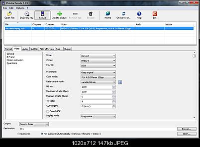

  1. I updated my copy of XMediaRecode to version 3.1.9.3 and no longer see the option to control video bitrate, such as when recoding a VOB file to AVI. Did Sebastian dumb down his nice program, or did he just hide it from amateurs, like me?

    Hi!
    The only problem with the VOB file to AVI?

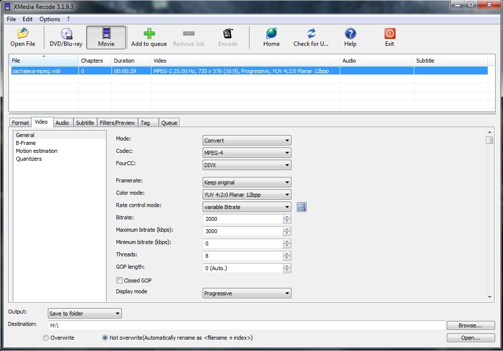

  3. You selected ABR. I thought a constant bitrate could be also be controlled. My mistake. Thanks for pointing that out to me.
    Because MediaInfo identifies the (variable) bitrate of the 1,048,574 byte VOB file as 4129, I selected an "average bitrate" of 4200 in XMedia for the conversion. The file was rendered as 4 GB. So I lowered the ABR in XMedia to 1800, but the AVI is still over 3 GB. I expected the file size to be at least less than 2 GB, since I lowered the bitrate by more than 60%. I tried using the built in "Bitrate Calculator" but could not make any sense of it.
    Then I tried AVS Video Converter that also offers an output file size calculator, based on the bitrate setting; but it too is useless. Is there a video converter that offers a reasonably accurate file output size based on bitrate selection in terms of Kbps (not %)? It does not need to be precise... not way off like the two I tried. Maybe there is a formula I could use. I don't mind doing a little math on paper.
