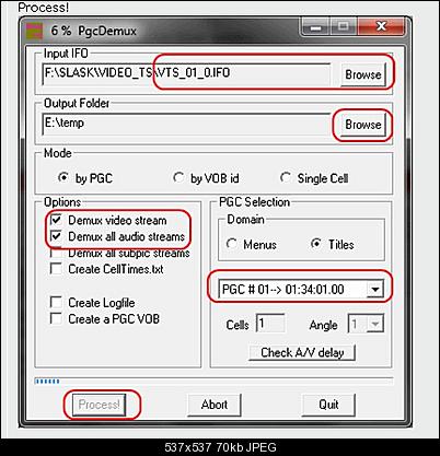

    I have authoured a DVD of three recorded from TV programmes using AVStoDVD, the finished article has a sound delay of around 70ms for some unknown reason, to correct this I want to use PGCDemux and MUXMAN,
    I loaded the Video_TS IFO file into Demux following this guide....
    But the PGC selection box only shows an LU 1 # 01 00:00:00.12 and NOT a PGC file.
    I can get it to display a PGC file but only if I load ONE episode into DE-MUX at a time, is it possible to DEMUX the whole DVD, or do i have to do just ONE episode at a time, meaning I have to Authour the DVD all over again

    Select 'Titles' in the domain selection area, located just above the PGC selection dropdown. It sounds as if you may have it set to 'menus'.
    Dec 2002
    Thanks for the replies folks, If i select the whole DVD file it wont let me change to Titles, but if I select the single files, all is ok.......I guess ill have to do it that way, Thanks again, your learned assistance is very much appreciated
