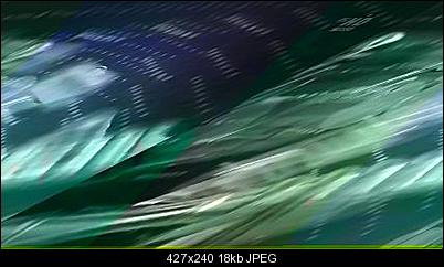

    I kind of remember experiencing a mod2 oddness at some stage (long time ago) when playing video using this PC. The video would be filled out with a green bar or the last row of pixels would be repeated, but as you asked, I had a bit of a play to see if I could duplicate it again and couldn't. I'm still using the same video card but probably different drivers, although I dragged out an old pre-LAV version of MPC-HC (as that's what I would have been using) and mod2 played fine no matter what I did.
    So aside from that one playback issue which maybe I imagined, there's DirectShow not always playing nice with mod2 widths, which in the end is the only reason I'm still a little cautious about it, and I think that's just a Windows API limitation and nothing which is a cause for worry in the real world. I've never had a problem playing mod2 h264 video using other devices.
    Mind you even the DirectShow thing is confusing me now. I created a little video with a resolution of 1218x720 for testing and opened it with a DirectShow script in MPC-HC and it displayed perfectly. I tried the same thing with a 854x480 video and the result was the pic below. Is the mod2 problem resolution dependant? I'll have to play around with that some more at some stage, but it won't be for a few days.

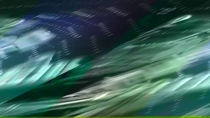

    Well here you go.... I managed to find one combination which produced some oddness with mod2. ffdshow's hardware decoder and the "system default" renderer for MPC-HC. Windows XP. So maybe I wasn't imagining it. It's like the edge of the video is being stretched to mod8 or something. Hopefully it's not too hard to see. I haven't tested other mods yet (out of time today) but maybe it's a DXVA thing? Whatever the cause..... I've still not seen it happen outside of PC playback.
    The same pic (cropped differently) and the brightness bumped up a little for the second one.

    I'm still not sure it's a hardware decoder issue as such, because it doesn't happen with every renderer. Decoding with ffdshow's DXVA decoder each time.....
    I choose the system default renderer in MPC-HC's options and the last row of pixels is repeated as per my previous pic. MPC-HC's File/Properties menu shows Video Size: 864x480 (AR 427:240). Keep in mind it's really 854x480 with square pixels.
    Switch to the overlay mixer and I get a black bar down one side. MPC-HC now reports Video Size: 864x484
    Switch to VMR9 and we're back to Video Size 854x480 and it displays as it should.
    As a quick test I found an old version of MPC-HC (pre LAV filters) which supports DXVA on XP and it's exhibiting the same oddness, so I guess it's not ffdshow's fault. It's over my head...
    As is the DirectShow thing..... why would some mod2 video display fine and some not so fine?

    @hello_hello: do you know an decoder which has problems with mod2 ? (I only enforce mod4 for interlaced 4:2:0 content.)
    I'm currently encoding Astro Boy with a resolution of 698x572 (MOD2 x MOD4) and VLC is adding a green bar on the right edge as I play it. As far as I'm aware VLC relies solely on internal codecs so I'm not sure why there would be a problem.
    (If I switch to Windows GDI output the green bar goes black)
  13. As is the DirectShow thing..... why would some mod2 video display fine and some not so fine?
    Some of the older DirectShow Filters are really picky when it comes to mod2, but ffdshow should normally work fine. Renderfilters also are sometime picky regarding mod. (Never really bothered looking further into it, since all my systems play fine using madvr.)
    Sep 2012
    Australia
    Nevermind. Switching to OpenGL rendering fixed it.
  15. Originally Posted by Selur View Post
    I think I'll just try to forget about it and go back to a newer renderer myself, although that's the reason I still have a little mod2 width paranoia. Aside from the PC (Windows), I've never had a mod2 playback problem I can recall, and no problem with mod4, mod8 or mod16 at all.
    You did make me feel better though..... knowing it's not just me.
