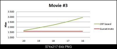

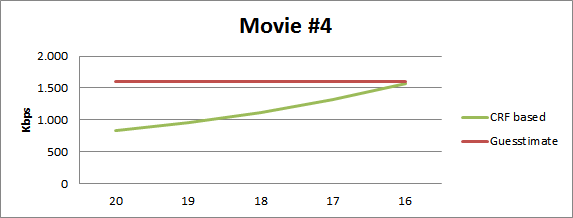

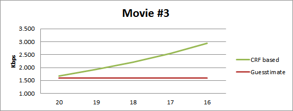

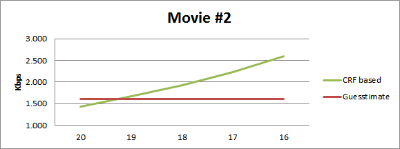

  22. Hi, masters!
    As promised I made some test. I tried to backup some movie (SD/PAL) using different values of CFR. I was almost convinced of the benefits of CFR but honestly after these tests I figured out that the resultant bitrate seems to be too unpredictable and often oversized.
    When I was using the xvid encoding I always used an average bitrate within a range between 1.600 and 2.048 Kbits (depending on resolution) and I never had noticeable problems (keep in mind that I am not one that checks the video frame by frame). In other words it was a kind of safety zone in which I was reasonably sure of getting a good encoding at the first shot, avoiding the risk of a decline in the quality explicitly observable while watching the movie. Using x264 I expected to decrease this range at least of 25%.
    Sometime it happens. Even too much... In some cases with CRF 18 I obtained a bitrate nearly embarrassing, so was low (see "Movie #4", below). But in many other cases I obtained completely opposite results (see "Movie #2" and "Movie #3", below).
    For 720x400 resolution, for instance, the bitrate obtained using CRF 18 seems to be often oversized. In some cases I obtained a bitrate much greater than the one I used to encode the same movie in xvid and with which i got a video absolutely appreciable. The figures don't add up... but maybe there is an explanation.
    As the algorithm of quality recognition can be sophisticated will never have the feeling and good sense of a human being (also because the human feeling is subjective). For example, a source video could contains some little dithering or artefacts nearly invisible to the human eye while watching the movie but absolutely visible to the CRF algorithm (enough to get mislead).
    Surely I need more experience but currently I'm inclined to use this simple rule: use CRF18 but if the resultant bitrate is higher than the setting used in the time of xvid, then re-process the video using that value for a two pass encoding.
    What do you think?...
