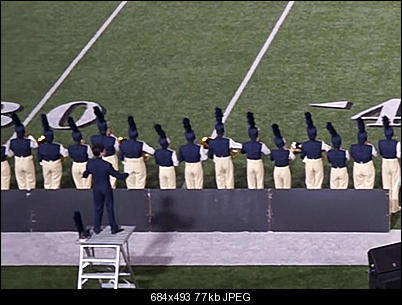

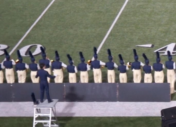

  15. I am back to post some comparisons. The video I am working with is AVCHD 1920x1080i30 that I am trying to convert to 30p. I have chosen a frame grab during a portion of the video where the camera is panning while the subjects are are perfectly still although the drum major is moving his arms. The frame grabs are roughly 640x480 crops/zooms.
    1. First frame grab is a simple weave using ffmpeg conversion to ProRes $ffmpeg -i input -vcodec prores -r 30000/1001 -an output.mov
    2. The second image is using yadif in ffmpeg $ffmpeg -i input -vcodec prores -r 30000/1001 -vf yadif -an output.mov
    3. The last image is using QTGMC with avisynth with a Slow setting to an AVI bitmap format
    As can be seen, the need for deinterlace is crucial from just a single frame grab since this video is a marching band on a football field (similar to green screen but with vertical yard lines). It becomes painfully obvious that the viewer is watching interlaced material. But as shown in frame 2, yadif's simple bob plus whatever else it might be doing results in a fairly blurry image. I have to say that I am pretty impressed with the QTGMC example as the image is considerably sharper.
    Now I just need to figure out how to speed up QTGMC on my computer and play with some of the settings more. Hopefully I will be back to post some more comparisons.
    Also, I am running avisynth through Virtualdubmod and just doing a Save As in Virtualdubmod where it saves the avisynth output as an AVI. Does anyone have a better way of doing this?
    Thanks again for all the helpful feedback.
  16. Originally Posted by SameSelf View Post
    As can be seen, the need for deinterlace is crucial...
    Depends on the player. DVD, for example, and BluRays, will be deinterlaced by the player or TV set. But I wouldn't call it 'crucial', in the sense that you think it necessary to deinterlace when reencoding, unless maybe you're uploading to YouTube or using a non-deinterlacing player for some reason.
  17. Originally Posted by SameSelf View Post
    It's not just "fairly blurry image" for yadif . You're looking at still images. In motion you will see "marching ants" artifacts, sort of buzzing or flickering along lines . The biggest strength of QTGMC IMO is the temporal smoothness, almost as if it were shot progressive in the first place without the flickery deinterlacing artifacts. In fact that's why it'd predecessor, TGMC was written in the first place - to reduce "bob flicker"
    I would recommend using vdub instead of vdubmod if you are wanting an AVI. But ffmpeg can accept avs scripts directly if avisynth support has been compiled. That gives you more options - so it really depends on why you are doing this / what scenarios / what your desired output goal(s) are
    There are some scenarios where you might want to leave them interlaced. For example, if you are producing for broadcast, or blu-ray.
  18. Originally Posted by SameSelf View Post
    This has already been done. I applaud you doing it for yourself so you can come to your own conclusions, but no one needs to see more evidence of what they already know to be true.
  19. My main goal for deinterlacing is this video will eventually find its way onto youtube. So rather than rely on youtube to deinterlace, I prefer to do my own thereby ensuring the best quality. As for Blu-ray, aren't all players progressive format anyway? With modern HDTVs the need for interlace support seems just quaint.
