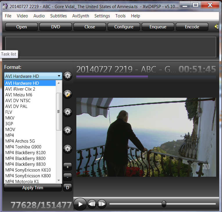

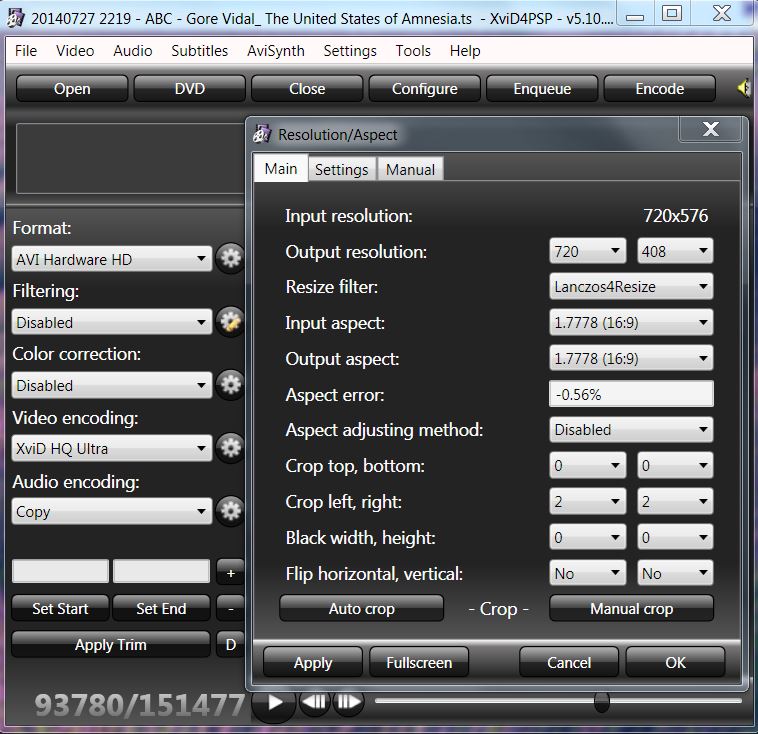

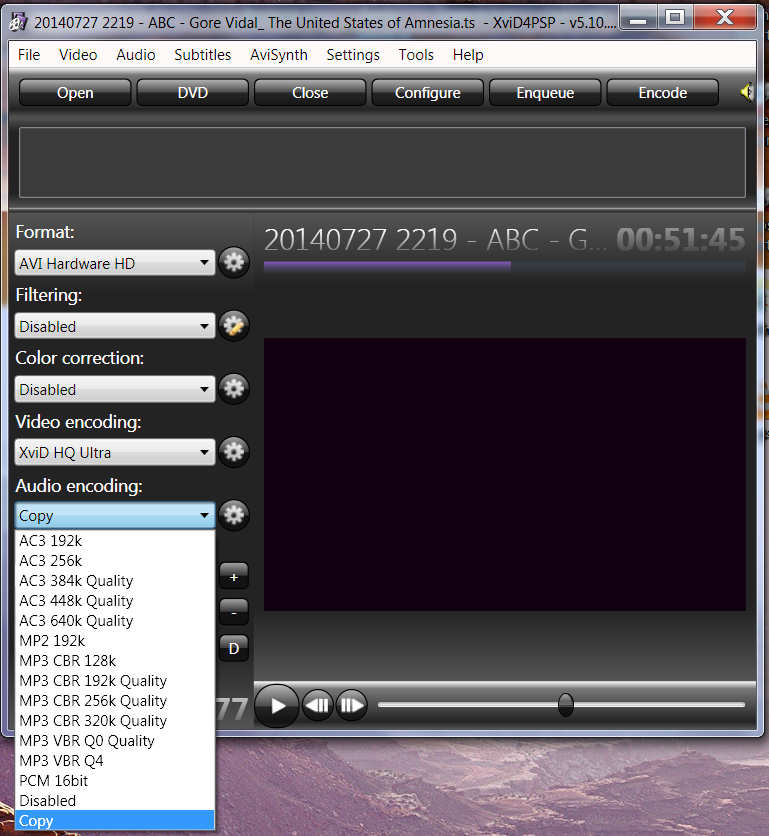

    I am experimenting with Xvid4PSP as I don't normally use it BUT it is a good program.
    In the meantime I was able to reduce a 4GB TS file down to a tad under 2GB. Looks ok certainly not Blu ray quality.
    This is what I used - loaded in a file from my off air PVR, then I selected via the drop down menu from FORMAT AVI Hardware HD, then going to the menu item along the top of the screen VIDEO selected aspect ratio and change it to 16:9.
    Next looking at the Audio button bottom left I changed it to Copy (no need to waste time re encoding the audio) so the setup looked like these images
