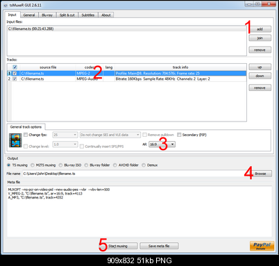

  18. Originally Posted by footychic View Post
    Ok TsMuxer have no idea how to use it where to make the changes you suggested
    0) Start TsMuxerGui.
    1) Add your source file
    2) Highlight the video track.
    3) Set the AR to 16:9.
    4) Browse to set the output filename.
    5) Start Muxing.

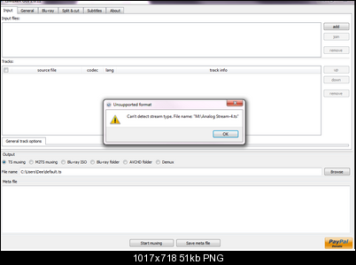

    Please help I still can't do this I don't have the same options as you

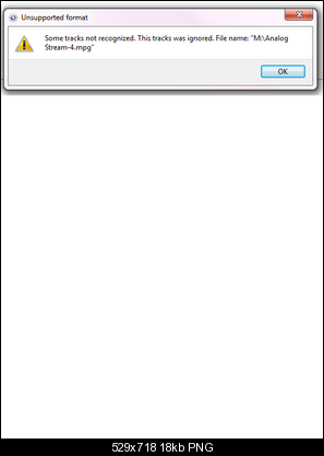

    I am also getting this messageClick image for larger version

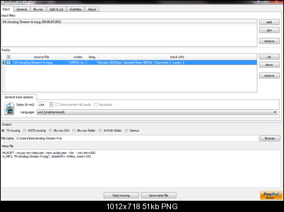

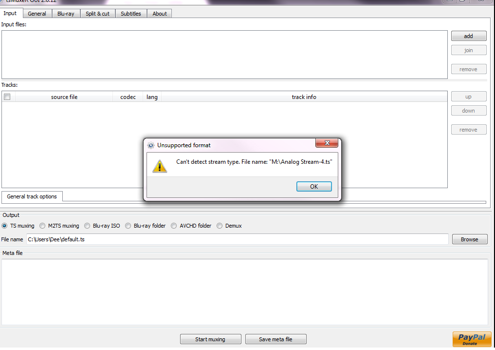

  21. Rename you source file "Analog Stream-4.TS" instead of "Analog Stream-4.mpg". Then try again.
    MediaInfo shows that the container is MPEG-TS (should have the extension .TS), not MPEG-PS (should be extension .MPG or .MPEG). Having a Transport Stream with an MPG extension is confusing TsMuxer.

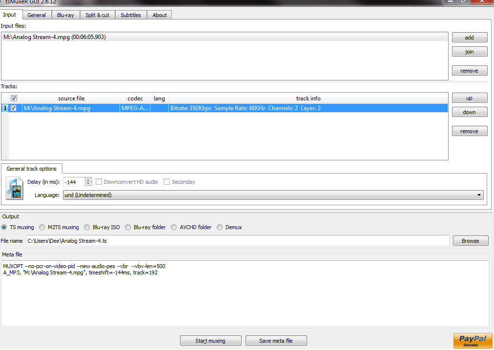

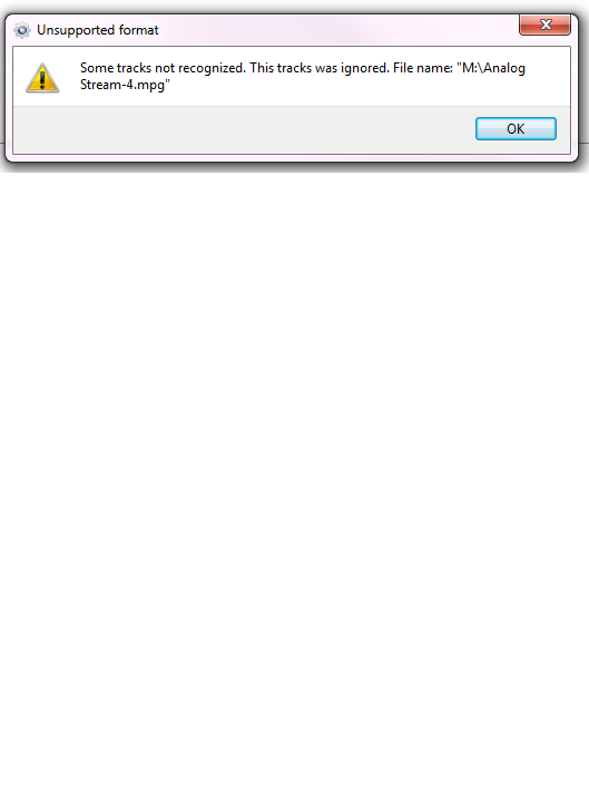

    I can't believe this what am I doing wrong.Click image for larger version
