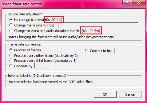

    So... I have an .avi here that's on 60.100/60.102 fps, as it can be seen here:

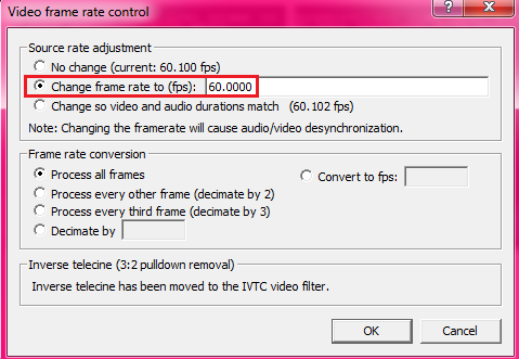

    and I want to make it go down from 60.100/60.102 to 60 fps. So I tried to do this:

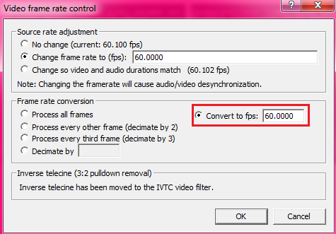

    then I saved my video but the audio went out of sync. Even after doing frame rate conversion to 60 fps. Like this:
    So... basically, I want to do what I said previously. I want to make my video go down to 60 fps but at the same time, I want the audio to be synced with the video.
    I was wondering if it's possible to do something on the window below to fix this issue:
    But I don't know exactly what to do. Can someone help me please...?

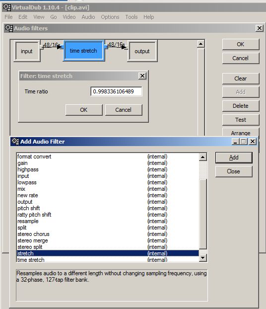

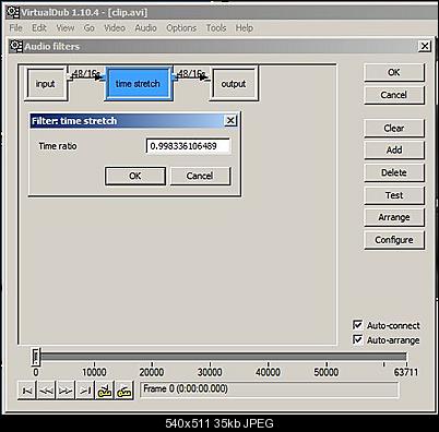

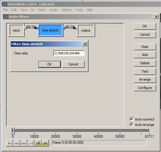

    I know there's a 'time stretch' filter under Audio > Use Advanced filtering - might work.
    Click on the 'time stretch' box to set the value.

    Three questions:
    1) On "video frame rate control", should I check only "change frame rate to (fps)" and set the value 60 or do I need to "convert to fps" as well?

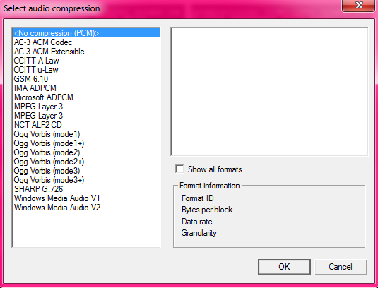

    2) Seems like I need to compress the audio to make the filters work. What compression method should I select on the window below?
    3) I can see you have "stretch" highlighted on your bottom pic and it confused me. Should I select "stretch" or "time stretch" ?

    Use Time Stretch. Also, the number to put in the box should be
    the result of old frame rate/new frame rate.
    For example, 60.1/60 = ~ 1.00167
    Set the video to direct stream copy/change frame rate to...
    If your existing audio is 2-channel, install Lame ACM and use that for the new audio.

    'Time stretch' to keep the pitch the same.
    You still have to recompress the audio whichever one you use.
