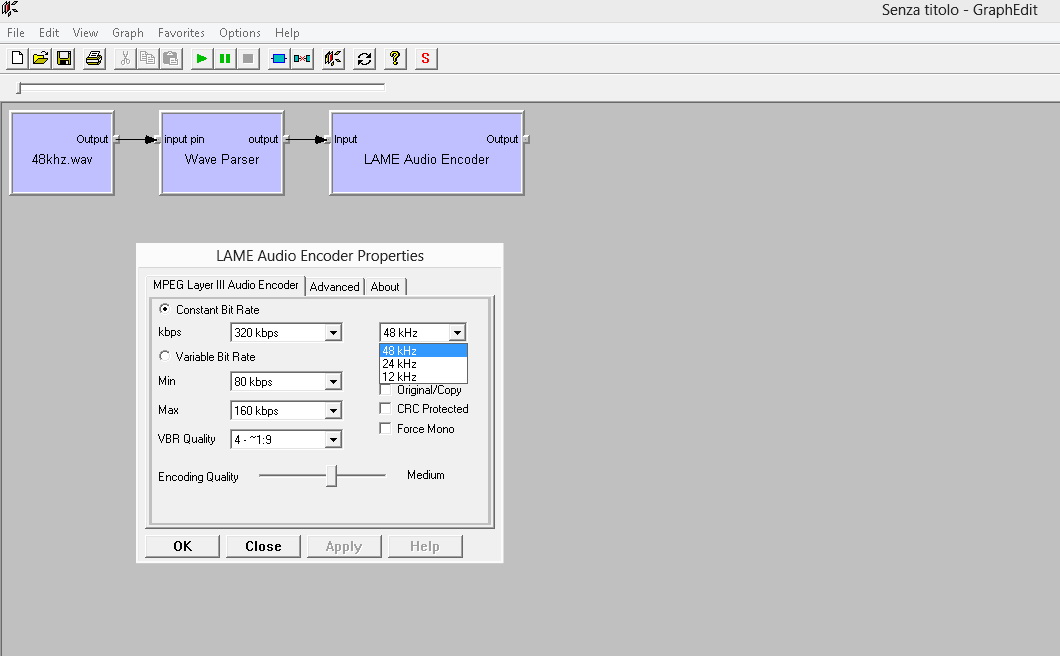

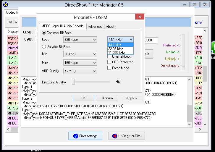

    I have install the lame.ax directshow audio codec but seems to me it's 44.100 khz but I need the 48Khz mode. Can I find a version of lame codec that have 48 khz? thanks

  2. You need to connect the input pin to a 48Khz source, and the 48Khz option will appear

  6. You directshow chain has to have 48Khz source in order for directshow lame to show the 48Khz option
    You can demonstrate that or construct a directshow graph in graphstudio / graphedit for example

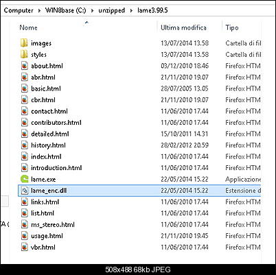

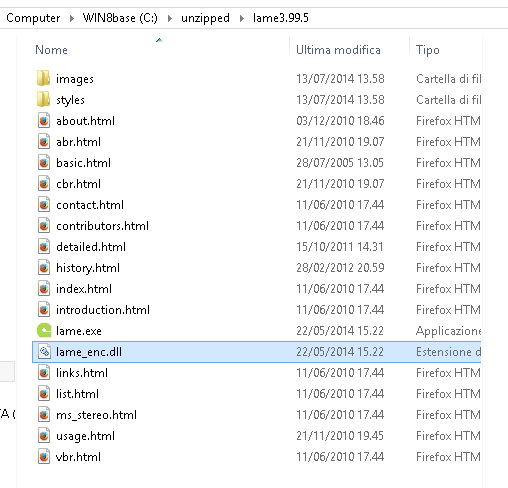

    I see only this file in the uncompressed directory:

    http://www.rarewares.org/mp3-lame-dshow-acm.php
    How to install on Win7 x64:
    1. Extract it to for example c:\lame
    2. Run cmd with admin rights (ctrl+shift+return)
    3. cd %windir%\SysWOW64
    4. rundll32 setupapi.dll,InstallHinfSection DefaultInstall 0 C:\lame\LameACM.inf
    (Thanks to Markus Stein.)

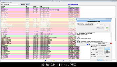

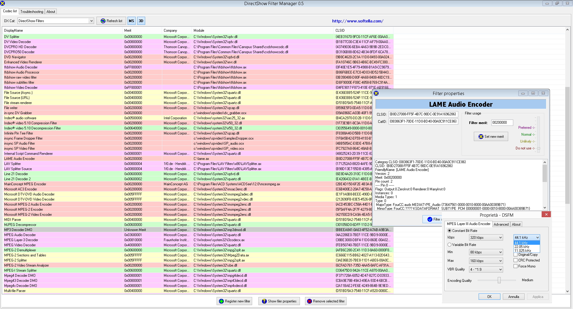

    poison I have download graphstudio and graphedit but I don't know what I have to do. I can see the lame.ax codec in the codec's list of the DSFMgr but now what I have to do in the graphedit/graphstudio to have the 48KHz able in the codec? thanks

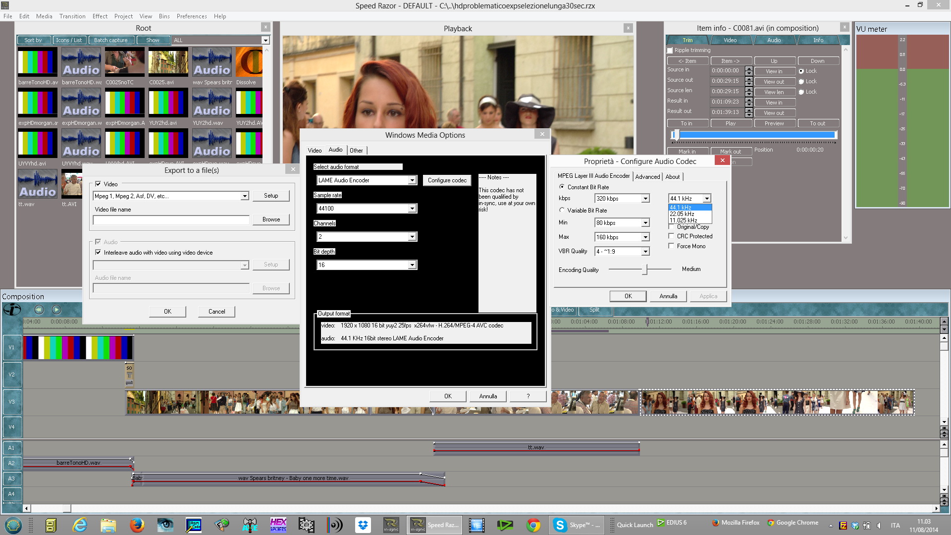

  11. Maybe I can see the 48 khz option when I do this in graphedit:

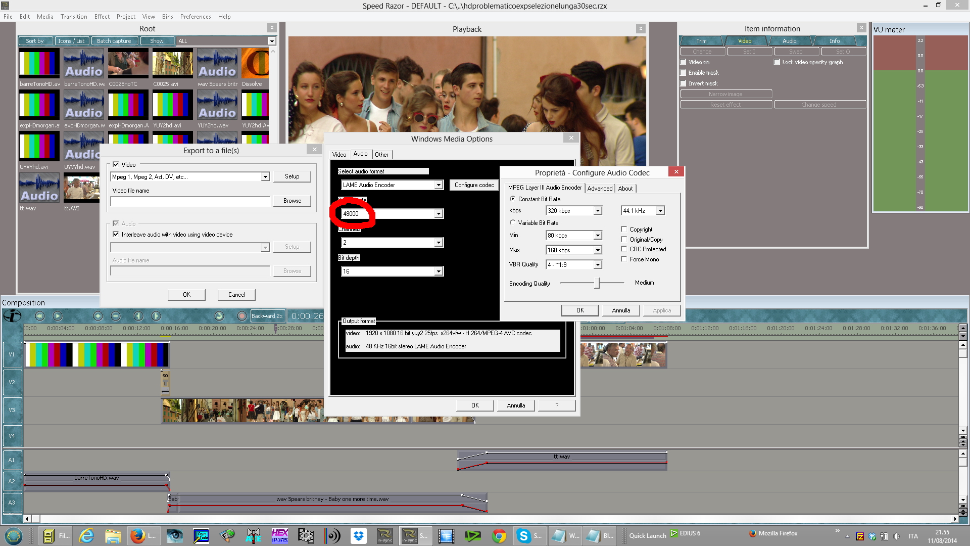

    but when I go inside the SRFC(Dino)-NLE I cannot see the 48khz option when I try to set the audio encoding option. Or I can install anhother audio encoder but I don't know what encoder
    my target is encode audio @ 48 khz
  12. I wonder: is there a way to have 48 khz in the nle?
  13. maybe my cat have found solution: problem is the BladeFormats.dat of the nle
    it have to be configured so:
    [Uncompressed (YUY2)]
    FieldOrder 1=1
    Can Change ColorSpace=1
    ColorSpace 1=1
    [Morgan Multimedia M-JPEG SD codec]
    FieldOrder 1=1
    ColorSpace 1=1
    [x264vfw - H.264/MPEG-4 AVC codec]
    FieldOrder 1=1

    [LAME Audio Encoder]
    Sample Rate 1=48000
    Can Change Sample Rate=0
    Sample Rate 2=44100
    Bit Depth 1=16
    Can Change Bit Rate=0
    Bit Depth 2=8
    Bit Depth 3=-1
    Channels 1=2
    Can Change Num Channels=0
    Channels 2=1
    And then the 48000 appears. The new settings override the 44100 of the "configure audio codec" property page and the final output is 48 KHz

  14. maybe my cat have found solution: problem is the BladeFormats.dat of the nle
    FieldOrder 1=1

    [Attachment 26840 - Click to enlarge]
