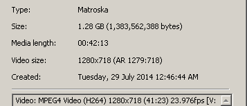

    Unless that's how it's supposed to be resized. It's possible a video with a 1280x714 resolution is supposed to have a 16:9 aspect ratio, so resizing it to 1280x720 when re-encoding wouldn't be a bad thing. You can check that with MPC-HC and the File/Properties menu after opening a video. This is the first example I found of a something similar. The resolution is 1280x718. The aspect ratio is (very) slightly different. If they were the same no (AR) info would be displayed.
