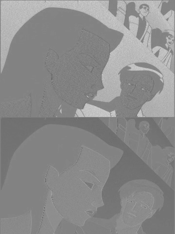

  3. What you suggested seems to have helped some.
    Its doing more harm than good though. Its not only losing color in some things but its also thinning lines alot and making it look worse. Several things look ruined as well like all of the background colors and lines and its extremely noticable. Its also ruining the scenes with alot more colors in them. I tried lowering the depth some but then the rainbows are visible again.
    BEFORE
    AFTER
    I thought awarpsharp in mergechroma was a line thinner or chroma sharpener and that's what I've been using it for, why would that get rid of rainbows?
    I usually use it like this for chroma sharpening when color is bleeding over lines in both directions.
    MergeChroma(aWarpSharp2(depth=10))
    Ive never used this before, is that the reason?

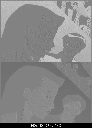

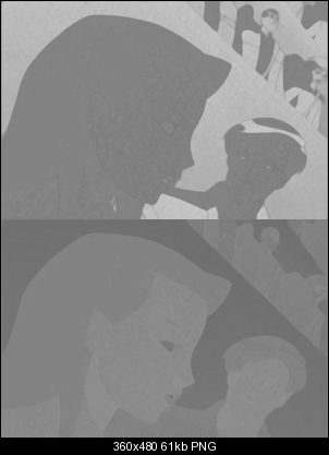

  4. Originally Posted by killerteengohan View Post
    The combination of downscaleing and upscaling blurs the chroma channels (as well as the luma). aWarpSharp is then used to sharpen the chroma (and luma) channels. MergeChroma then merges the modified chroma with the original luma (throwing away the blurred/sharpened luma).
    If you look at the chroma channels you'll see oversharpening (?) halos.
    StackVertical(UtoY(), VtoY())
    Before the above filtering:
    After filtering:
    Feel free to try other resizing and sharpening filters.

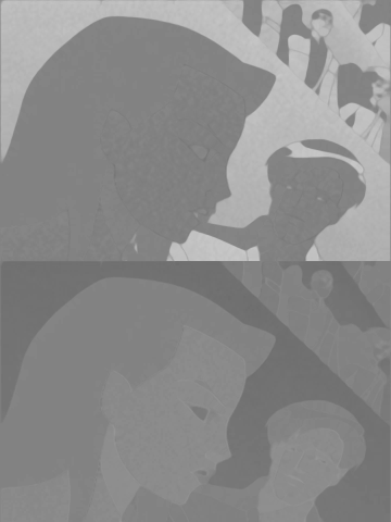

  5. Well it looks like too much detail and or colors are getting ruined with current method.
    Lanczosresize usually looks better to me but not in this case, your suggestions looks better.
    Do you have an alternate suggestion for the sharpening filter awarpsharp? That seems to be whats doing the things I don't like to the video.
