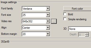

    but why the subitles are at the middle of the frame? (they are centered but also in the middle right on the actors faces)
    in SE i used the avi's resolution...
    Image Attached Images
  4. Before you export your subtitles in SE mark them, right-click and select alignment. (Where on the frame)
    The Align in the above select how each line is justified, ie right, left or centered.
  5. it didn't work.
