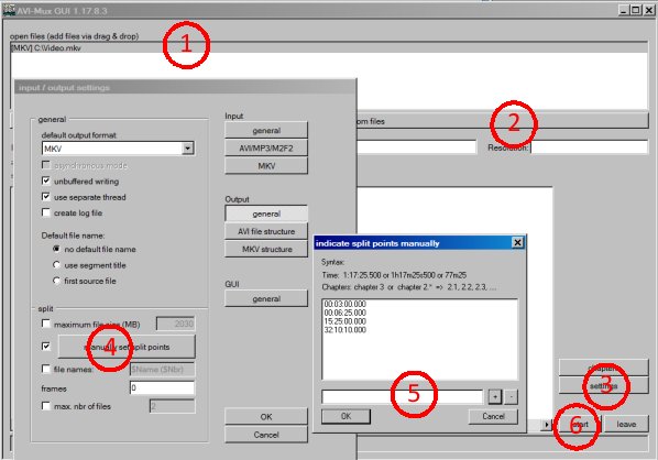

  5. can't i do that in one action?
    You can with Avi-Mux GUI
  6. Avi-Mux GUI crush
    cant load it

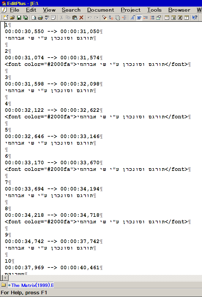

  16. i need to be able to choose WINDOWS-1255
    i can only choose ANSI but after that i need to choose WINDOWS-1255
    & i can't
    not with MediaCoder & not with Handbrakes ...

  22. DECEASED
    Jun 2009
    Heaven
    Because you refused to share your Hebrew SRT, I downloaded one from opensubtitles.org
    And yes, it was created as UTF-8 text
    BUT because anyone can upload **** that will remain on their servers "forever" until it is reported,
    I could not be sure that I had gotten a valid file

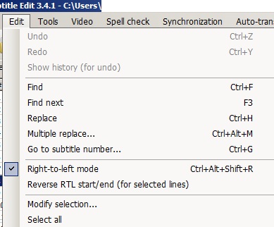

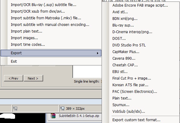

  23. Originally Posted by videobruger View Post
    In SE use Edit -> Right-To-Left mode and Edit -> Fix RTL via Unicode and export as PGS. Mux with MKVMergeGUI and MediaCoder using Default render for Subtitles will automatically use ID 0 (your PGS)
    (It sounds to me as if your problem is more of a subtitle problem than a cut problem and that your subtitles is not properly formatted to begin with and need to be "fixed" but without knowning your subtitles it's hard to tell. And there may be other options/formats )
    thanks but
    i can't find Fix RTL via Unicode
    and export as PGS
    EDIT: i uploaded 2 images - they look here as 1

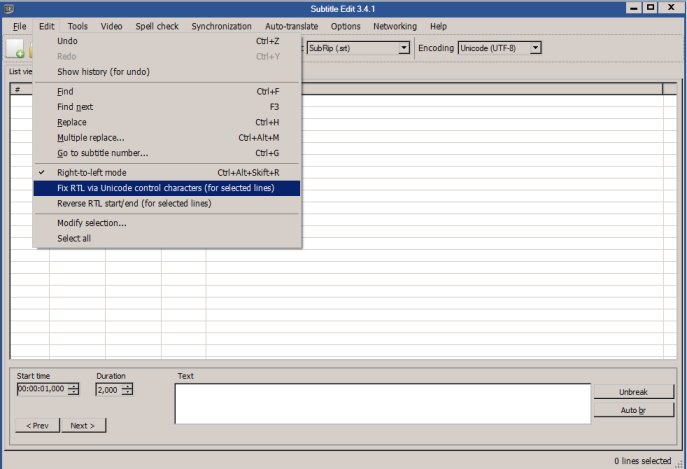

  24. PGS is Blu-ray sup in your image.
    Fix RTL you find here
  25. how in my app there is no fix rtl? as you can see in the screenshot...
  26. i did a test & i think its ok
    i need to check it with the original file
    but its strange, why i need to Mux the sup file with MKVMergeGUI and after that give MediaCoder the same sup file again? the file already exist in the mkv
  27. that give MediaCoder the same sup file again
    ?? You don't have to do that. It's in the muxed MKV. Just use ID 0 (default)
    And BTW I always use the portable version of SE and the option Edit -> Fix via Unicode has been there since vers 3.3.13
