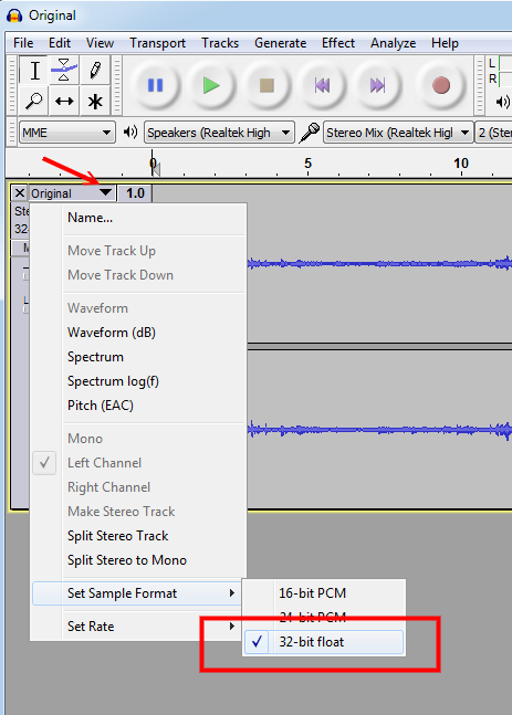

    Anyway, that looks pretty simple except..."process with 32 bit floats" I have no idea what that means. I've not used audacity much at all.

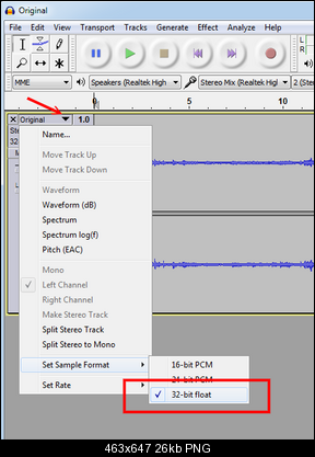

  23. Yes, I used the right channel. It had more loud pops but it had a better signal to noise ratio. ie, more signal, less noise (aside from the pops). For 32 bit floats use the pulldown next to the file name at the left of the track:

    [QUOTE=jagabo;2363115]Yes, I used the right channel. It had more loud pops but it had a better signal to noise ratio. ie, more signal, less noise (aside from the pops). For 32 bit floats use the pulldown next to the file name at the left of the track:
    You, sir, are a legend. Thanks. The pops are no problem. If I remember they are only right at the start, in a part I won't be using. It's odd that the right channel is better. I wonder if the mic was attached upside down...it makes more sense for the Left to be better, since the camera was on my right shoulder.
