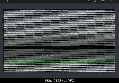

    For 1080i only audio and crap video check the img n top

    1080i:

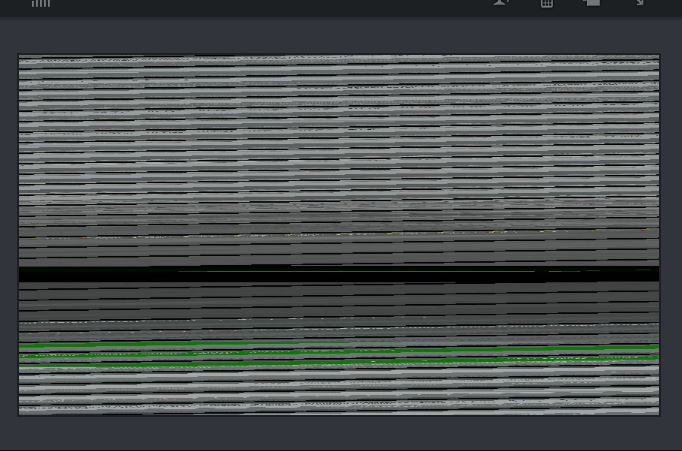

  10. UPDATE
    Tried with XBOX 1080i result:
    Nothing with other resolution

    Originally Posted by tko4 View Post
    UPDATE
    Do you mean that you tried the XBox at 1080i with component cables connecting the XBox directly to the Slingbox, or do you mean that you connected the XBox to the Slingox via HDMI + HDMI Splitter + component converter?
