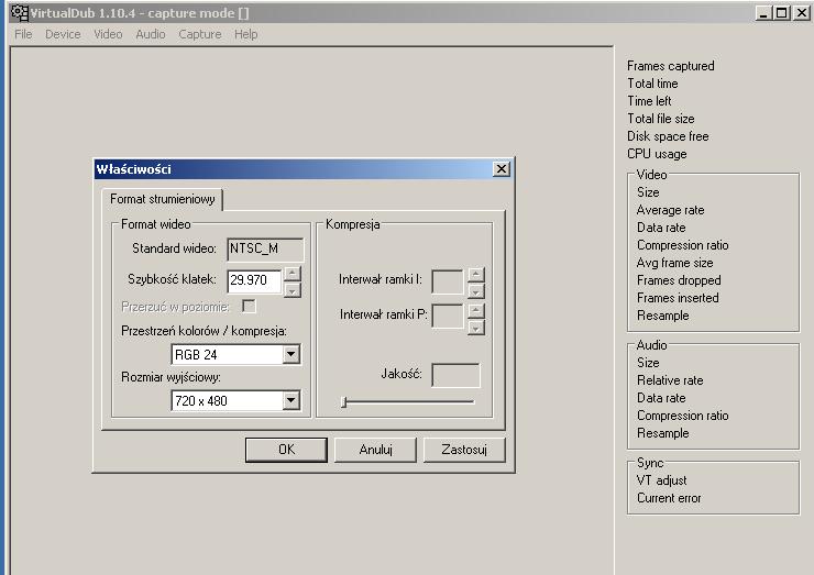

    I am in process of capturing my old VHS tapes. I have some tapes recorded in NTSC and PAL. I have successfully captured in RAW format all my NTSC tapes. Now I want to start the same process for my PAL recorded tapes. What setting do I have to change within VirtalDub? How I can switch from NTSC format to PAL in VirtualDub.
    As you can see on the picture, my standard video format is not changeable from this window.
    [Attachment 26748 - Click to enlarge]

  2. The equivalent PAL settings would be 25fps, 720x576. Presumably you have to change the settings on your capture hardware (whatever that may be) as well.

    RGB24?! No no no.
    It's entirely possible your capture drivers don't offer PAL support, though that would certainly place it in the vast minority. Even if it does, you may still be out of luck with this capture device as I think it's unlikely the VCR outputs a real PAL signal (I don't recall how multisystem VCRs sold in North America work though; maybe they don't have the same problem as the Euro machines playing real NTSC).
