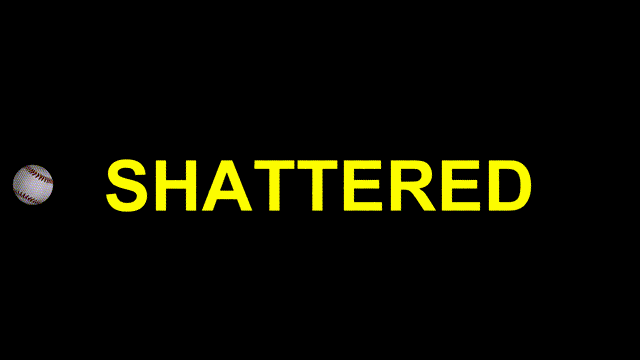

  4. Member racer-x's Avatar
    Mar 2003
    3rd Rock from the Sun
    Shatter like this?
    Attached is a zip file of project so you can see how it was done.
    Last edited by racer-x; 6th Aug 2014 at 18:27. Reason: Added zip file of project for learning purpose.
  5. For shatter you can set the "start time" parameter for when you want it to occur. Even if it didn't have "start time", because multiple tracks are available you can do some trickery as well by staggering layers and using duplicate layers trimmed to the section of interest - you can do that to modulate any effect
    PNG transparency works by default
    Which transition did you need help with ?
  6. Member racer-x's Avatar
    Mar 2003
    You can also animate the direction of shatter on various axis. I forgot that I can simply export animated GIF.
