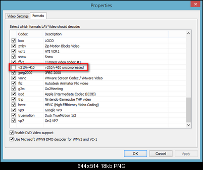

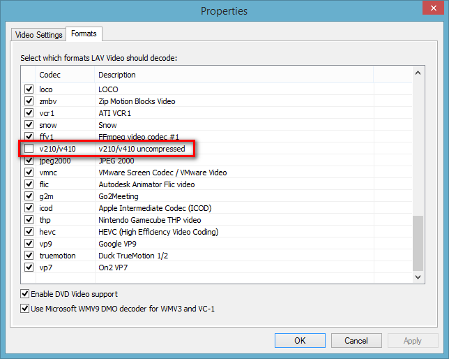

  6. Click image for larger version
Name:	2014-08-03 16 04 58.png
    Maybe I misunderstood but LAV Video has V210 decoder, it just needs to be manually enabled in settings.
  7. The LAV filter built into MPCHC doesn't include v210. At least, the version I have doesn't include it.
  8. OK,
    found it in LAV Filters, but I can't find this page in internal LAV Filters of MPC-HC
  9. I added external LAV Filters to MPC-HC and now it works.
