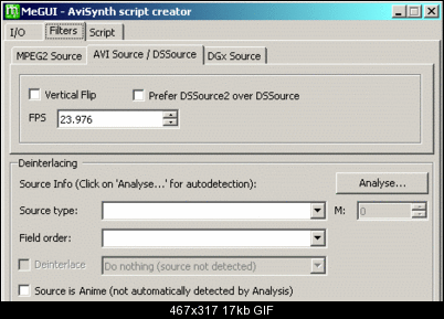

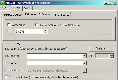

    Thought I'd mention..... the option in the script creator which lets you alter the frame rate after opening video via either DirectShowSource or AviSource looks like this (for ffms2 you need to change the script yourself):
    but..................
    If you've opened a video via DirectShow it converts the frame rate by duplicating or dropping frames as required (which would be what you'd want, I assume), but if you've opened a video via AviSource it changes the frame rate by speeding it up or slowing it down, so the number of frames wouldn't change, they'd just whiz by faster or slower.
    I'm not sure why the same setting in the script creator works differently depending on how the video is opened, but it's something to keep in mind. There's no reason why MeGUI couldn't add frame rate "conversion" to the script for both methods, but maybe there's a reason it doesn't which escapes me at the moment.
