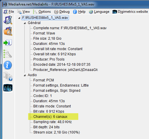

    Hi !
    Quick question here :

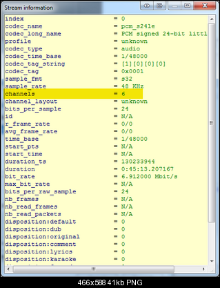

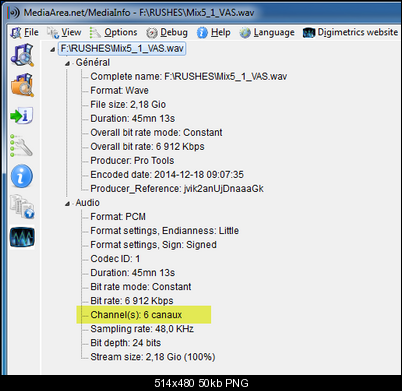

    I got a multichannel 5.1 wav :

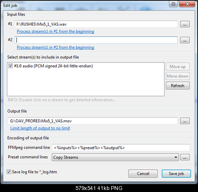

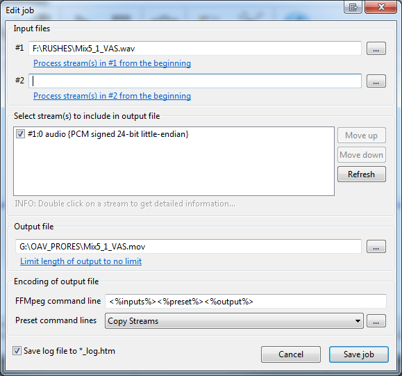

    but when imported into FFQueue, it only detects 1 stream.
    I was counting on this little gem of a GUI to create a 6 mono + video file, as I didn't manage to get it done in CLI (those ffmpeg mapping options ! è_é)
    but... something's wrong here.
    Any help ? How can I get FFQueue to detect the 6 audio channels ?

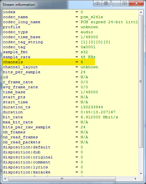

    You can have multiple channels in the same audio-stream. Please double-click the audio stream in the stream-list (in ffqueue's job-editor) and verify that ffprobe recognizes it as 6 channels

    Hi TorBru, thanks for the quick response.
    Indeed, FFqueue detects well 6 channels.

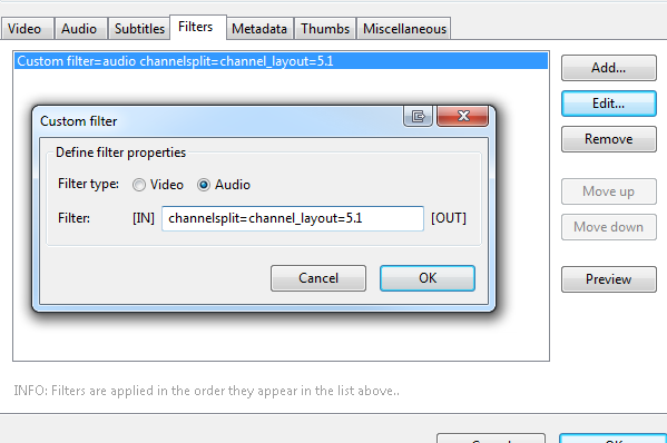

    Ok I tried to add a filter, but apparently, the filter menu stays grayed out when video & audio are on "Copy - Copy unmodified source stream"
    no pb : i chose pcm audio codec.

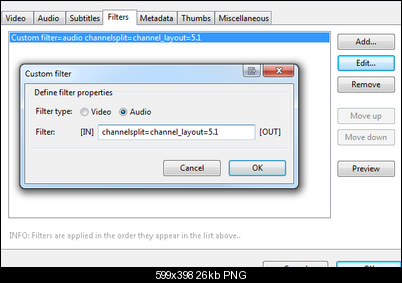

    BUT, after writing the custom filter
    I get an error. I Checked the log file, it says :
    "Simple filtergraph '[1:0]channelsplit=channel_layout=5.1' does not have exactly one input and output.
    Error opening filters!
    FFMpeg exited 2015/05/01 14:06:33, running time 00:00:00.119
    Job completed irregularly - please check output above for detailed information!"
    I looked up FFMPEG info page u linked, but its kinda obscure to me... Did I write the wrong parameters in FFQueue Custom Preset ?

    You did it right - FFQueue uses the -af option for audio filters and that causes the problem. Remove the custom filter again and go to Miscellaneous and add:
    -filter_complex "[a:0]channelsplit=channel_layout=5.1"
    to the "First pass" command line arguments.
    I'm the developer behind FFQueue. My posts might reflect this! ;-)
