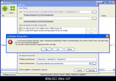

    Another problem encountered...
    Loaded *.ts file (of "BD profile-compliant" 720p60 MeGui/x264 2passVBR19Mbps-encoded video+LPCM 16/48/2 audio, muxed in TSmuxer) to be rewrapped into .MP4 container (already created an ffmpeg/ffqueue preset of "passthrough/copy").
    This is what popped up immediately upon loading the file:
    What up with dat?!
    What up with dat?!
    Thaks for you bugreport!
    Looks odd.. Is it reproducable, does it happen each time the file is loaded? Does it happen when the "Refresh" button (next to streams) is pressed for that file? Does it happen with other files (of similar type) or is it just that file?
    I'll do what I can to fix it when I've got the time and a clue of what's wrong

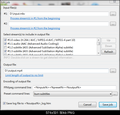

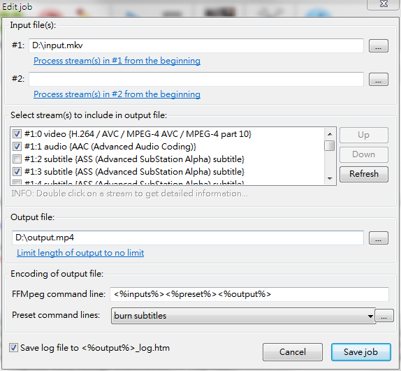

    burn a subtitles stream to video
    Starting FFMpeg 08/21/14 23:38:31 with command: -hide_banner -map 0:0 -map 0:1 -filter_complex "[0:0]subtitles=D\\:\\\\input.mkv:si=3" -vcodec libx264 -acodec libfdk_aac -ac 2 "D:\output.mp4"
    Invalid input file index: 0.
    FFMpeg exited 08/21/14 23:38:31, running time 00:00:00.056
    Job completed irregularly - please check output above for detailed information!

    1) The advanced scale settings are what I would consider to be expert features - but you can still use them with FFQueue without any problems. The newly updated scale filter (Version 1.1.31) supports advanced inputs and you can simply enter your algorithms into the width and height fields since number validation has been ditched. You can also create a custom video filter (last item in the filter menu) and enter your scaling requirements that way. The setsar / setdar filters can also be integrated to the filter chain by using a custom video filter.
    2) The mapping issue is defenately a funny little bug and I must really have been tired that day! It was introduced the day I cleaned up the command line - I might have cleaned it up a bit too much since the input file was cleansed also LOL! However, you can dodge this issue by entering the D:\input.mkv file in both #1 and #2 and then select the video and audio streams from #1 and the subtitles from #2 = problem solved. I will fix this issue for the next release, thanks again for the report of this issue!

  27. I hope the GUI can do it, using different settings for each output stream.
    For example, using different tab pages for setting each stream.
    Like this:
    Tab Page:
    1. Make a drop menu for selecting the input stream. (-map input_file_id:stream_specifier)
    2. Make a drop menu for selecting the format of the output stream. (-c:stream_specifier)
    3. Make some needed options.
    Stream #0:0[0x1011]: Video: h264
    Stream #0:1[0x1100]: Audio: truehd
    Stream #0:2[0x1100]: Audio: ac3
    ffmpeg -i input.m2ts -map 0:0 -map 0:1 -map 0:2 -map 0:1 -c:0 libx264 -b:0 8000k -c:1 copy -c:2 copy -c:3 libfdk_aac -ac:3 2 -b:3 320k output.mkv
    Stream mapping:
    Stream #0:0 -> #0:0 (h264 (native) -> h264 (libx264))
    Stream #0:1 -> #0:1 (copy)
    Stream #0:2 -> #0:2 (copy)
    Stream #0:1 -> #0:3 (truehd (native) -> aac (libfdk_aac))
    https://trac.ffmpeg.org/wiki/How%20to%20use%20-map%20option
  28. Member
    Jul 2014
    Denmark
    Like this:
    [Attachment 27137 - Click to enlarge]
    Tab Page:
    It looks like the features for another GUI than FFQueue since the requested features would require a rewrite of FFQueue. You can emulate the behaviour by creating the individual streams using FFQ and then remux/remap all the streams using "copy" codec to your final file.
    I've just released version 1.2.34 that includes some bug fixes and some new features like images to video, concat multiple files (audio/video) to one and such
