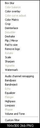

    Originally Posted by Chris K View Post
    Tried an old 2013 build and all filter option were greyed-out. Works fine!
    That's a bug that needs to be fixed since most filters are available in 2013 builds
    Version 1.0.23 just uploaded: fixes filter issue.

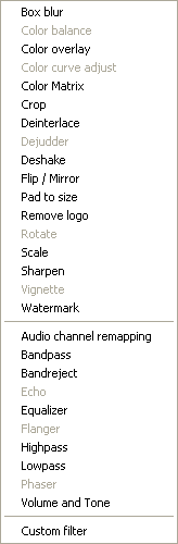

    Fixed! Wow, you are awefully fast.
