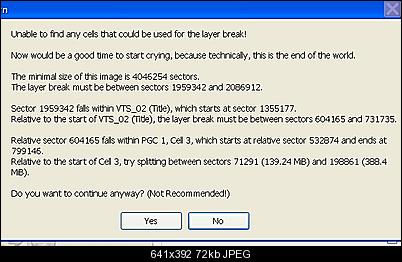

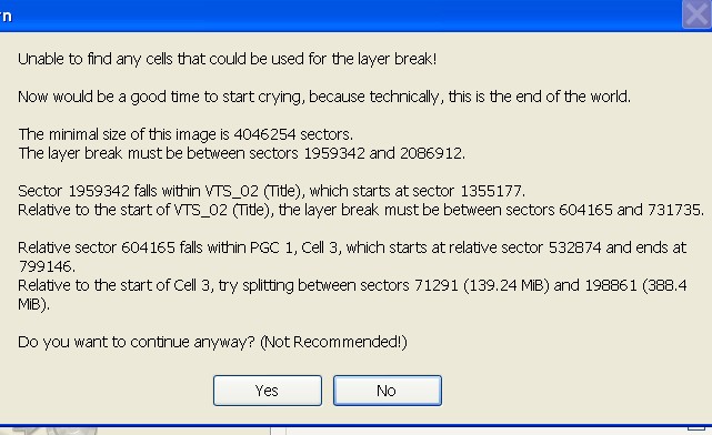

    This is the error message, i dropped the size down to 8000mb and it still displays this, I use DVD+R DL ARITA discs from a local supplier. and have rarely had any problems.

    Solution for the End of the World error message: http://forum.imgburn.com/index.php?/topic/6376-how-to-deal-with-the-end-of-the-world-p...em-in-imgburn/

    In an ideal dual-layer DVD situation, both layers are each 50% of the whole disc, and it just so happens there is a legitimate condition at that exact 50% mark with which to comfortably make the layer break. It will not be too practical, though, to guard things during authoring such that this gets to be the case, so ImgBurn, for one, allows a little leeway: layer breaks are created
    • with each layer a maximum of 3.96GB in size (note the GB notation to avoid confusion)
    • with each layer not necessarily the maximum size, as long as a suitable cell is found for the layer break, and the whole *.iso is less than 7.92GB
    • with the suitable cell marking a point which will create the bigger-sized layer which is 3.96GB or less
    It can be inferred fom these, therefore, that the probability a layer break can be created gets less and less the bigger the *.iso size gets, all the way to the maximum 7.92GB, and the fewer suitable cells are found.
    Chapter points are allowed only on an I-frame at the start of a GOP, which necessarily means that is a suitable cell to layer break with, so indeed, a way out of this problem would be to simply to stud the elementary stream with chapters galore during authoring.
    I have been in situations where I had to re-author two or three times an *.iso of 7.9GB just to add heaps of chapters at the point where ImgBurn says is around the 50% mark so that it sees a legit point to layer break and allow burning to disc. As for others, inclusing but not limited to OP, due to the programs used they may not be able to re-author and add chapter points. Or they deliberately refuse to believe chapter points (or their absence) can influence greatly whether a layer-break can be made and the disc burned.
