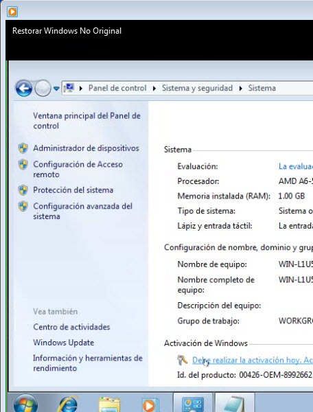

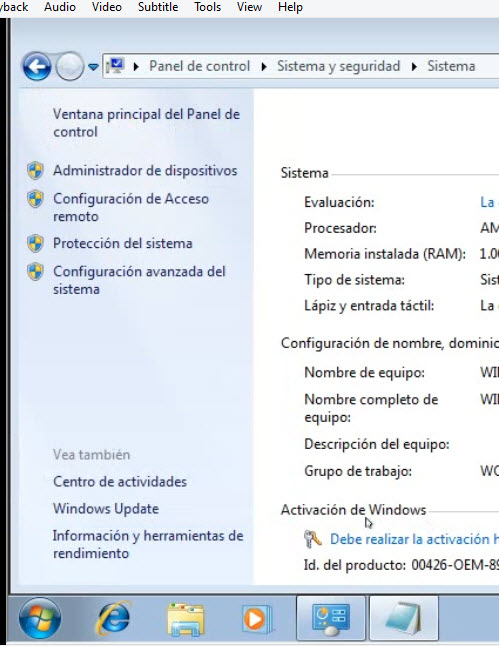

    canada

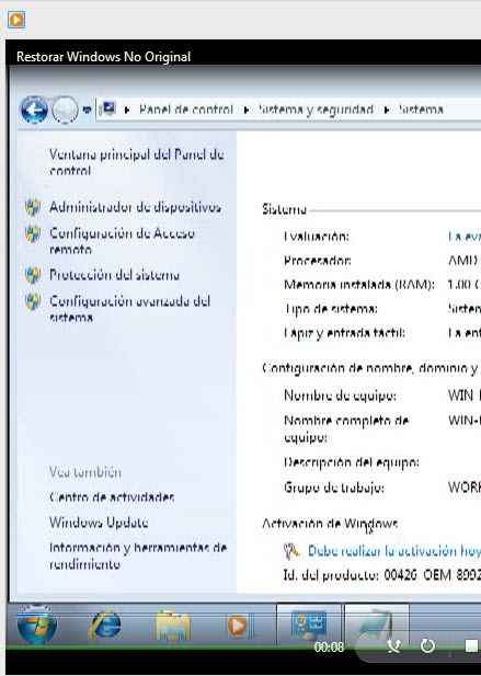

    pics attached.
Name:	Win 8 X64  Tosh laptop WMP 12.jpg
Name:	WIn 7 X86 WMP 12 DELL desktop.jpg
Name:	WIn 8  Guest VMware Workst WMP 12.jpg
    Jul 2014
    canada
    Previous images :
    1st image (top) is Win 8 X64 Tosh laptop WMP 12
    2nd image is (mid) WIn 7 X86 WMP 12 DELL desktop
    3 rd image is WIn 8 Guest VMware Workst WMP 12
    this last image is with VLC

  6. 1st pic looks like it's been deinterlaced (Something is triggering WMP to auto deinterlace)

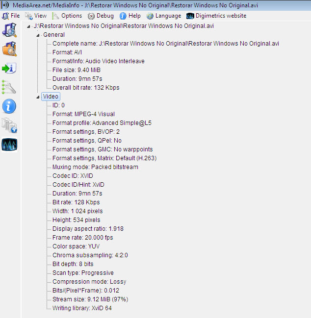

    What does mediainfo (view=>text) say about the AVI ?
    Jul 2014
    canada
    attached is media info

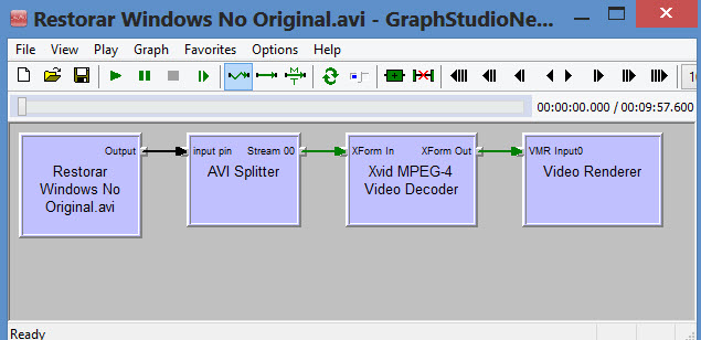

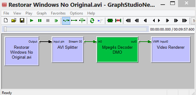

    Attached is the path for the file. I selected play on graphstudio and text is fine.
  19. That was on the host system with the problem? What do other computers look like with graphstudio ?
    I don't know why that particular WMP is doing this....
    The problem with WMP is it doesn't have very many configuration options.
    You can try setting a different codec with higher merit, or even selectic the current one and bumping it up, hoping that WMP will select it (graph => insert filter => find the one you want => change merit button => set it to something higher) . You might have to log out/log in for settings to take effect
    There is also another tool called preferred codec tweaker than can help manage system codecs. You migth try changing preferred to xvid or lav for example
    https://www.videohelp.com/tools/Preferred-Filter-Tweaker

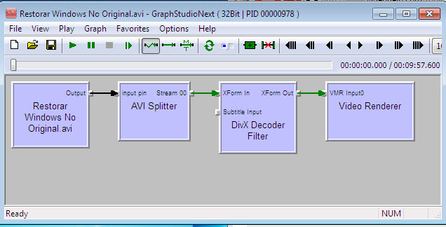

    here is what I see on a Win 7 X86 PC where WMP 12 displays text correctly. Is is different
Name:	Win 7 X86 WMP 12 okay.jpg
  23. On that last one, the Divx Decoder is installed and has higher merit than the default decoder (The Mpeg4 decoder DMO is the one that comes default with WMP in WMP 11/12). The one that automatically connects in graphstudio is supposed to be the one with higher merit (higher priority). You can can try setting it up the same way on the problem computer. DivX isn't installed by default on Windows, it's a 3rd party decoder

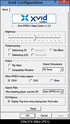

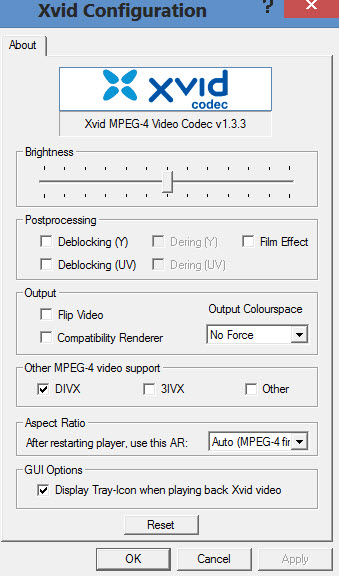

    The config settings for XVID are the same for both computers. Strange that they show differently. Attached.
    Thanks , I am off to shopping for a while.Click image for larger version

  26. Originally Posted by Rontierra View Post
    It doesn't matter because xvid is used for one, mpeg4 decoder dmo for the other. (the problem computer isn't using that xvid decoder according to graphstudio). If both used xvid for the decoder , then there might be a config setting you can adjust

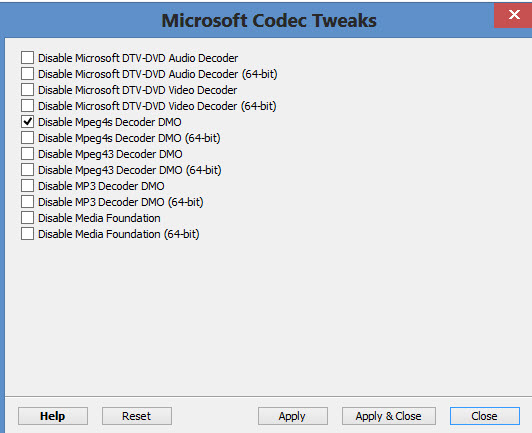

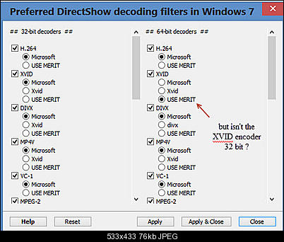

    This is what I did :
    Preferred : 64 bit XVID use merit (isn't XVID that I installed 32 bit ??)
    also need Disable MPG4s Decoder DMO ( what are the implications for other videos that I might run ?)
    Graph studio now shows differently but not quite the same as on Win 7 32 bit PC.
    Win Media player Now seems to play the text in the video properly on my Win 8 laptop
    Attached imagesClick image for larger version
Name:	Tweak setting 1.jpg
    What possible problems may this create. I will have to use it like this for a while to see if something else develops

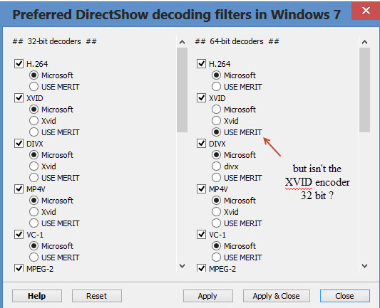

Name:	Tweak setting 2.jpg
Name:	graphstudio with tweaks.jpg

  30. You're using xvid decoder, not divx decoder as in your other computers. It doesn't matter since issue is resolved. Basically the problem is with your directshow setup as the differences in graphstudio suggested. You actually don't have to disable the MS decoder if you don't want to - another option is set a low merit to the MS one, and a high merit to xvid or divx (or some other decoder)
    There will be no potential problems, as all MPEG4-ASP videos in directshow will now be routed through xvid decoder. It is very stable. You will find 3rd party decoders are almost always better than MS default ones. The exception might be WMV/ASF family
    There are 32bit and 64bit versions of xvid vfw encoder and decoder, but it usually doesn't matter for the ENcoder for playback purposes. (ie. whether you ENcode with 64bit or 32bit version has no bearing on the file itself). But decoder is required to be the same 32bit or 64bit format as the playback software, or there has to be a way for the 32bit-64bit "handshake" to occur
