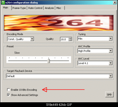

    And have a easy way to change between 8 and 10bits on MeGUI? Or i have to rename the x264's .exes ?
  14. o/ very easy thank you!!!
