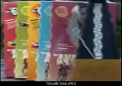

  7. Hi8 is neither top field first nor bottom field first. It's just an alternating sequence of top and bottom fields. When a DV device captures analog video it starts with a bottom field then adds the next field, a top field, to fill out the frame. That creates bottom field first frames. If you don't do anything that disturbs the field structure and encode as interlaced BFF for DVD they will play back properly on TV.
    Wavy vertical edges may indicate the frame was resized vertically without interlaced handling. For example, the software may have cropped 10 lines of head switching noise off the bottom of the frame and resized what was left to the original frame size. The size of the waves will vary depending on the amount of that was cropped:
    Download Mpg2Cut2 and extract a few seconds from one of your VOB files (Mark-in, Mark-out, File -> Save This Clip). Upload it here.
