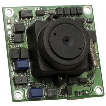

    I would also consider a regular 'spy' type camera as they are generally smaller and easier to place in a small frame. The downside would be that a 'capture card' would be needed. But if you wanted to use four cameras, that might be easier than using USB type webcams. Not sure you can get four to work at the same time over USB.
