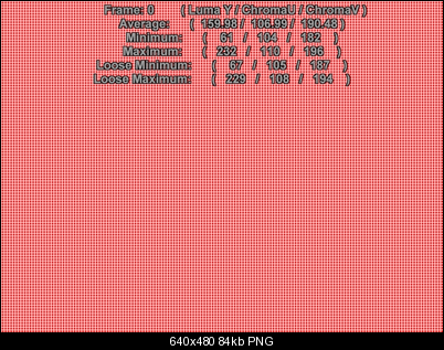

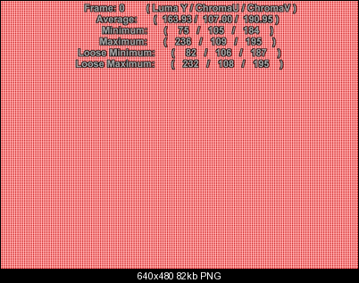

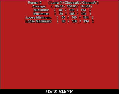

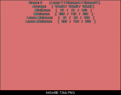

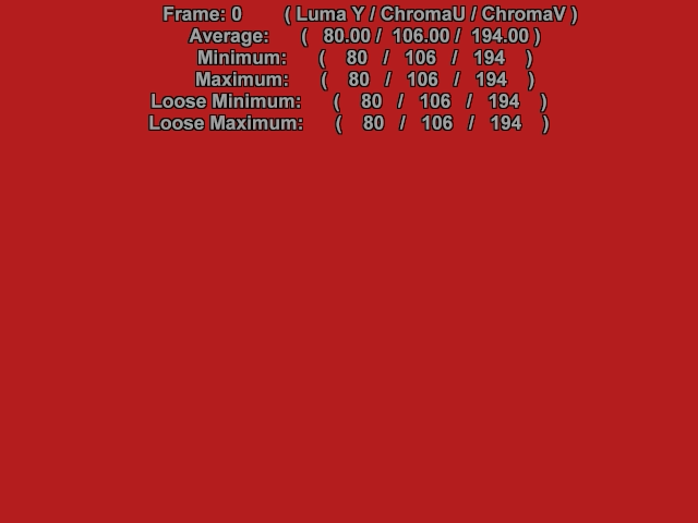

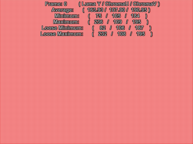

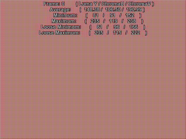

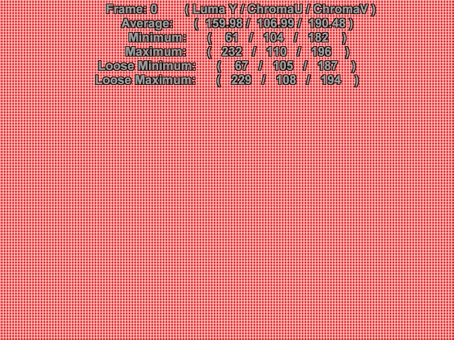

	Extreme example to illustrate
 santiag()
 coloryuv(analyze=true)
 a: lots of fine lines
 b: lots of fine lines + santiag
 c: no lines
 d: no lines + santiag
 e: lots of fine lines + santiag(2,2)
 Basically the more the fine details, the sharper your content, the more fine lines, the stronger the AA function, the stronger the effect
	Those are local changes not overall changes. You've just assured that the entire frame is filled with those localized changes. I doubt that's the OP's problem. He probably has an incorrect colorspace change somewhere. Last edited by jagabo; 27th Jul 2014 at 20:09.
