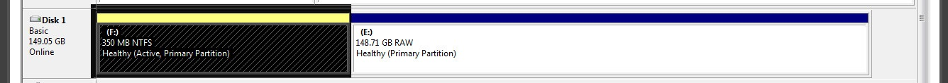

    We go into Disk Management i have highlighted in black where HDD LocalDisk (F) is found
    http://oi59.tinypic.com/2s1579g.jpg

    I am also worried about 'Drive E' which is alongside your drive. I think this is actually the drive you connected and not 'F'. 'RAW' is the give away here.
    You can attempt to recover the data but would need recovery tools to do so.

    as the picture shows e: and f: are one single drive with 2 partitions. the big one is raw and unformatted which means that any data that was on there is gone.
