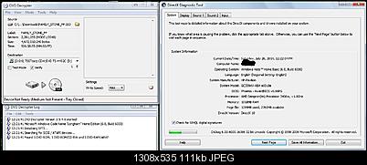

  1. Hey guys, I used to be able to use DVD Shrink and Decrypt along with IMGBurn on my laptop and desktop, and suddenly both just died out. My desktop info is on this img
    I use memorex disc DVDS. i used to be able to burn dvds 10's of 20's at a time. now this suddenly happened and the drive won't recognize there is a DVD inside.
    Help would be greatly appreciated.

    [Attachment 26599 - Click to enlarge]

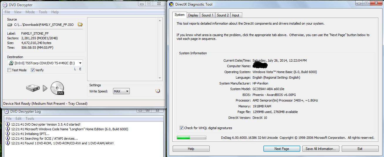

    It could also be the fact that a TS-H492C isn't a DVD burner.

    He can't burn from that drive he put the disc in. But according to that photo he posted, Dvd Decrypter lists that he also has a dvd-ram +/-dvd-rw drive. I believe the "medium not present" problem is because Dvd Decrypter can't handle the provided disc on it's own. The source file is an ISO and needs to be mounted, before Dvd Decrypter can do anything with it.
    Dvd Decrypter can handle ISO files directly. A DVD-ROM drive is not meant to handle empty discs when attempting to burn them, duh.
