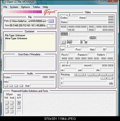

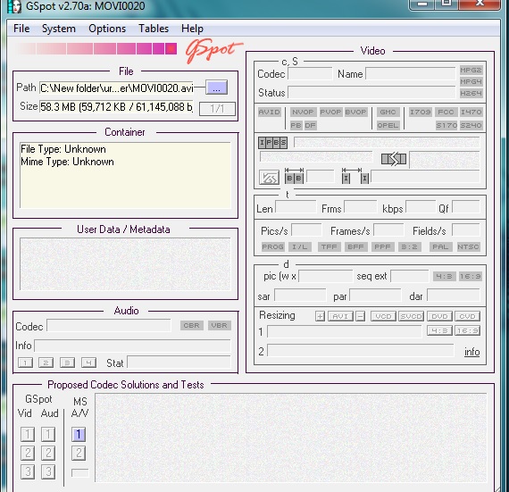

    Gspot shows no info about them (file type: unknown , mime type : unknown )
    AutoGK says format not supported.

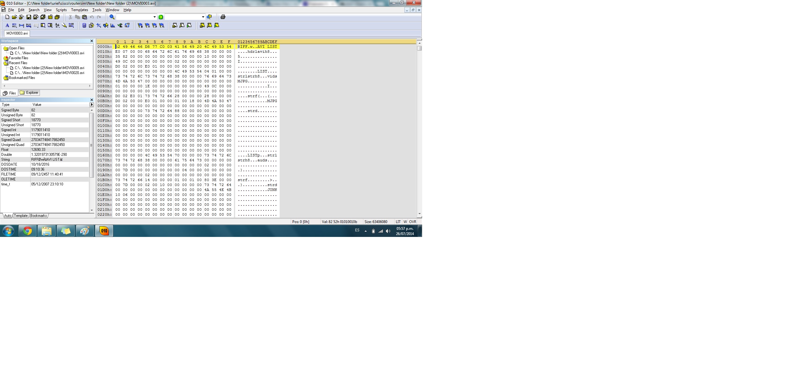

    Open up one of your bad ones in a hex editor. Does it have a similar start code sequence to one of the good ones? Or does it just have all zeros? Or is it something else? If all zeros, you're out of luck, as nothing was recorded. If similar, they might be fixable. Something else, couldn't say ATM.

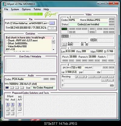

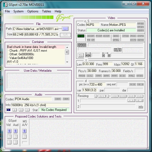

    This is the good one gspot info
    This is badone info

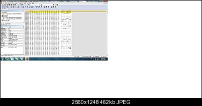

    Goodone Hex editor info

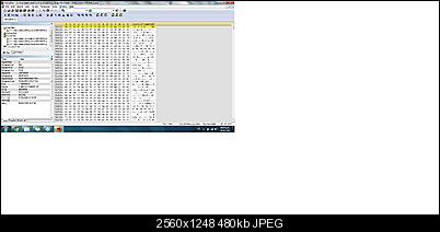

    Badone hex editor info
Name:	bad hex editor.jpg

    Don't give me gspot info, give me MediaInfo info!
    Also, your screencaps are unhelpful because the hex codes are so small as to be illegible.

  5. Seeing the hex dump... MediaInfo will not give you anything useful. The header of the AVI is gone and has been replaced by junk. It's gonna be tough getting video out of that file. One thing you might try is copying the header from a good file onto the bad file (make a backup, of course).

    I agree. There MIGHT be valid RIFF payload data in the file somewhere, but it certainly isn't at the beginning. In the hex editor, you could do a search on "RIFF" or "AVI", along with a few other reserved words and/or stream header codes.
    Now it comes down to a sophisticated, pattern-matching, cut & replace problem - if it works at all. Not well suited for newbies.
