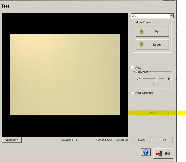

  21. Hi everyone
    I've just bought the reflecta super 8 scanner with firmware 1.013, downloaded CyberView S8 v1.1.2.15k(c0) from the website and installed it on my Windows 7 SP1 64 bit System.
    Unfortuntately the "capture" button is disabled! I have no idea why? There isn't any step that omitted. I can use the up/down buttons, the film transports "nicely". So the driver is installed properly.
    So I installed CyberView S8 v1.1.2.14i from the installation cd. The button is still disabled.
    So I've downloaded the firmware update V2008 from the vendor site and updated it. Still no avail.
    I have 4 physical HDDs installed with free space from 17GB up to 400 GB and tried to set the working directory to any of those drives. the button is still disabled.
    Anyone any idea why my capture button is disabled?

  22. Member
    Feb 2015
    England
    Hi StehtimSchilf.
    The only way I can reproduce this myself is to leave the gate empty. I think that before it will allow Capture, the firmware needs to see a correlation between motor action (e.g. using Up/Down) which should be moving the film; and the sprocket hole detector above the gate which can actually detect film motion. Do you have film (with good sprocket holes) threaded through the gate in the normal way? If so, check that nothing (such as dust or a piece of broken film) is obscuring the sprocket hole detector above the gate.
  23. Dear Neutron
    Thank you for dealing with my case. Unfortunately I do not understand what you mean with the "empty gate"? I've checked the english manual and couldn't locate the sprocket hole detector. Any detailed information are appreciated. The film is moving fine with the forward/rewind button of the scanner and the up/down button of the ugly user interface.
    As I've updated to FW v2008 the up/down button do not forward/rewind one frame but endlessly until i push the stop button of the scanner. Maybe something is broken with my scan device?
    SiS
  24. Member
    Feb 2015
    England
    Hi StehtimSchilf,
    If you look at post #97, the second photo is a close-up of the gate area with the LED housing folded back and no film threaded.
    The gate is at the bottom, and above it to the left is a vertical slot. When film is threaded, this slot is behind the sprocket holes. Behind the slot is what I think is a reflective opto switch to detect the holes in order to align the vertical scanning and sense film motion, but this is only a guess.
    I speculated that an obstruction here could make the firmware behave as if there was no film threaded, so not activate the Capture function.
    When you say the film is moving fine, do you see mages in the preview window? Your screen grab shows the yellow-white of an empty gate.
    The continuous motion you describe with Up/Down could again be the firmware failing to detect a sprocket hole signal, so not having any way of controlling a single frame movement.
  25. Dear Neutron
    My thanks for your detailed information. yes I do see an image in the preview window (I made the screenshot after I a complete rewind. Sorry for the confusion). and there is nothing obscuring the sprocket hole detector. I've pushed the forward/rewind buttons on the scanner a few times, activated the Auto Contrast and Auto Brightness a few times and suddenly the capture button beacame active. The sprocket holes are fine and the film is not dusty, though.
    short: it's scanning
    thank you
