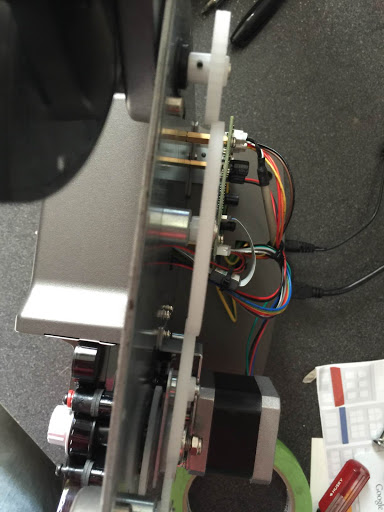

    Now, it does cause a little less engagement with the gear fro the take up reel. (see below)
Name:	Gear Above.jpg
    But still seems to be enough to drive it fine.
    I scanned a few reels successfully, but now have been getting the old 'film stuck' message anywhere from 100 frames to 1000 frames. And it's not really stuck as I can just push the capture button again and it continues fine (until the next stuck message.)
    Maybe it has something do with my flip or maybe not. Maybe I'll see if the take up gear can be move dout slightly to more fully engage.
    Anyone have a tried and true method for fixing the 'film stuck'?
    Thanks!

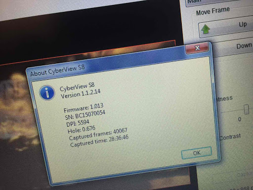

    My arm drop issue continues to be fixed. But my 'film stuck' continues to haunt me. Trying to get through a 400 foot reel. On my 3rd day. Keeps stopping with the film stuck warning. I click off and just click capture again and it proceeds for anywhere between 100-1000 frames before another message. Inb reading the above thread this sounds like it may be a software issue. I am running this:
    This is the version I should be running yes?
    Thanks in advance!

    Dear mickmc1, I couldn't help noticing your total scan time and frames: 28:36:46 hours for 40097 frames gives about 1400 frames/hour, if I am not mistaken, whereas I cannot capture more than 500 frames/hour.
    The only difference is that I am running CyberView S8 1.1.2.14m but I'd really like to downgrade to CyberView S8 1.1.2.14 to get that performance!
    Unfortunately, I cannot find it on Reflecta website.
    This is getting really frustrating.
    BTW: thank you for the arm drop fix hint, I had the same issue and flipped the gear as you suggested, now it seems to be fixed.

    Hello everybody,
    I want to share a tip, that is actually proving very helpful to me: try with different USB ports, especially if you are using a laptop. I think that the Reflecta has to be connected to a powered USB port and not every one is.
    I changed the port on my laptop and now I am running smooth capture sessions, no messages, no need to use my script... It's just working as it's supposed to (except for the arm drop that I fixed as Mick suggested); so far, so good.
    Try all the ports you have, or try to use a powered USB hub.
    Plus, I found (with a quick googling for "CyberView S8") CyberView S8 1.1.2.14 for Windows and I am using it with no problems, but now I am convinced that the issue was the USB port.
    I will finish capturing my reels (ca. 28 x 600 ft), then I will dedicate my efforts to restoring, with avisynth.
