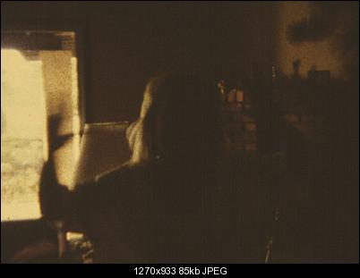

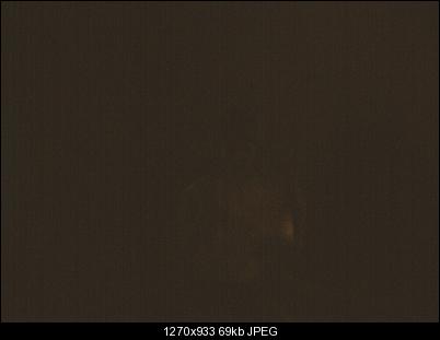

  2. Originally Posted by litemakr View Post
    It is similar but it moves with every frame, it's not fixed.
    If the pattern is the same but it moves because of the registration to correct for film bounce you may still be able to reduce it. Can you provide some short video samples? A handful of all black (except for the noise) frames, and some mixed dark/light frames from a film?
  3. Originally Posted by jagabo View Post

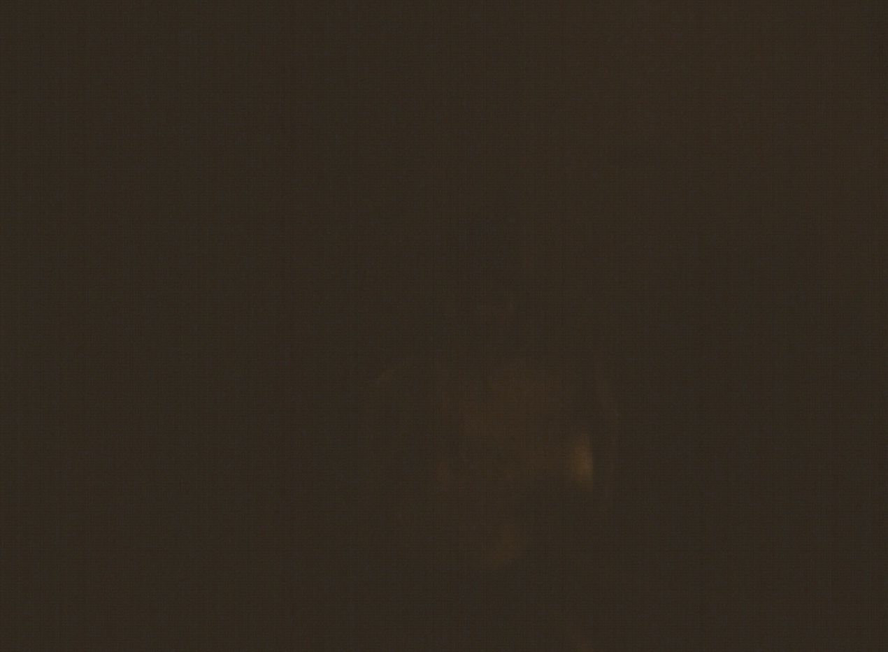

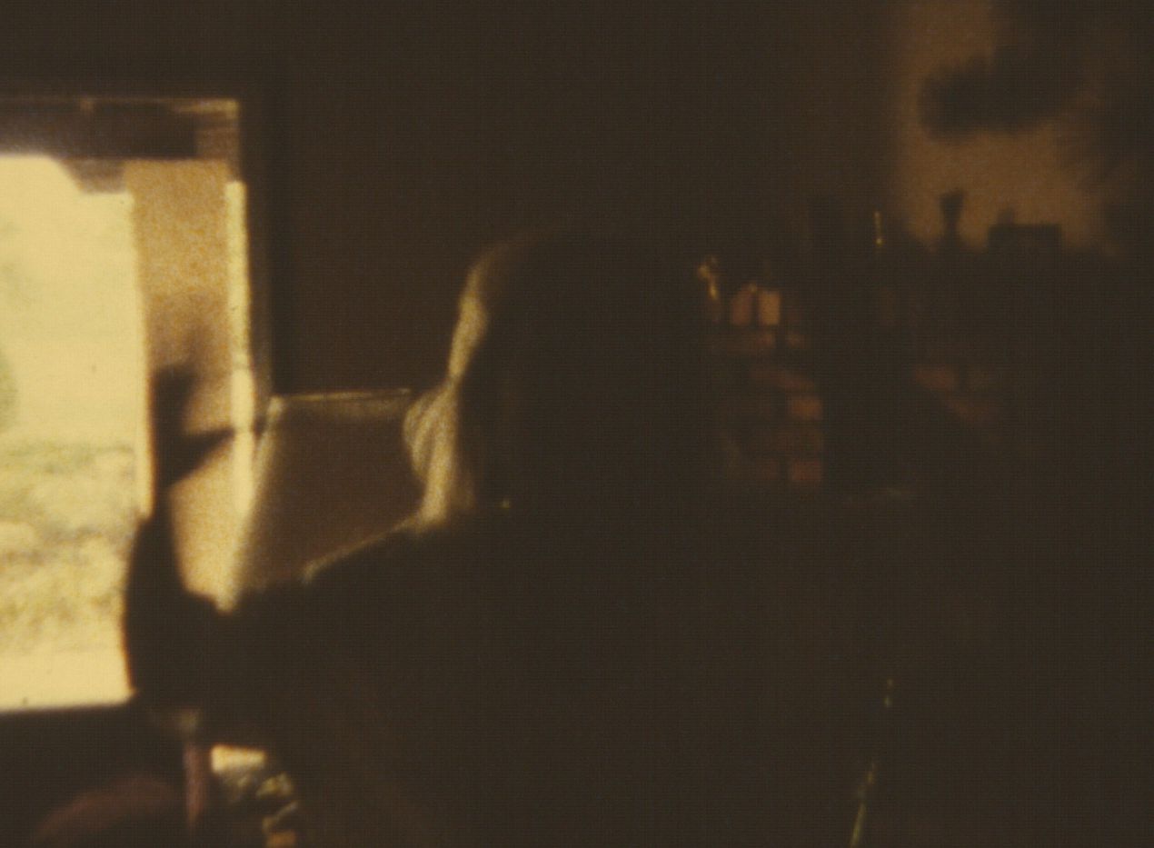

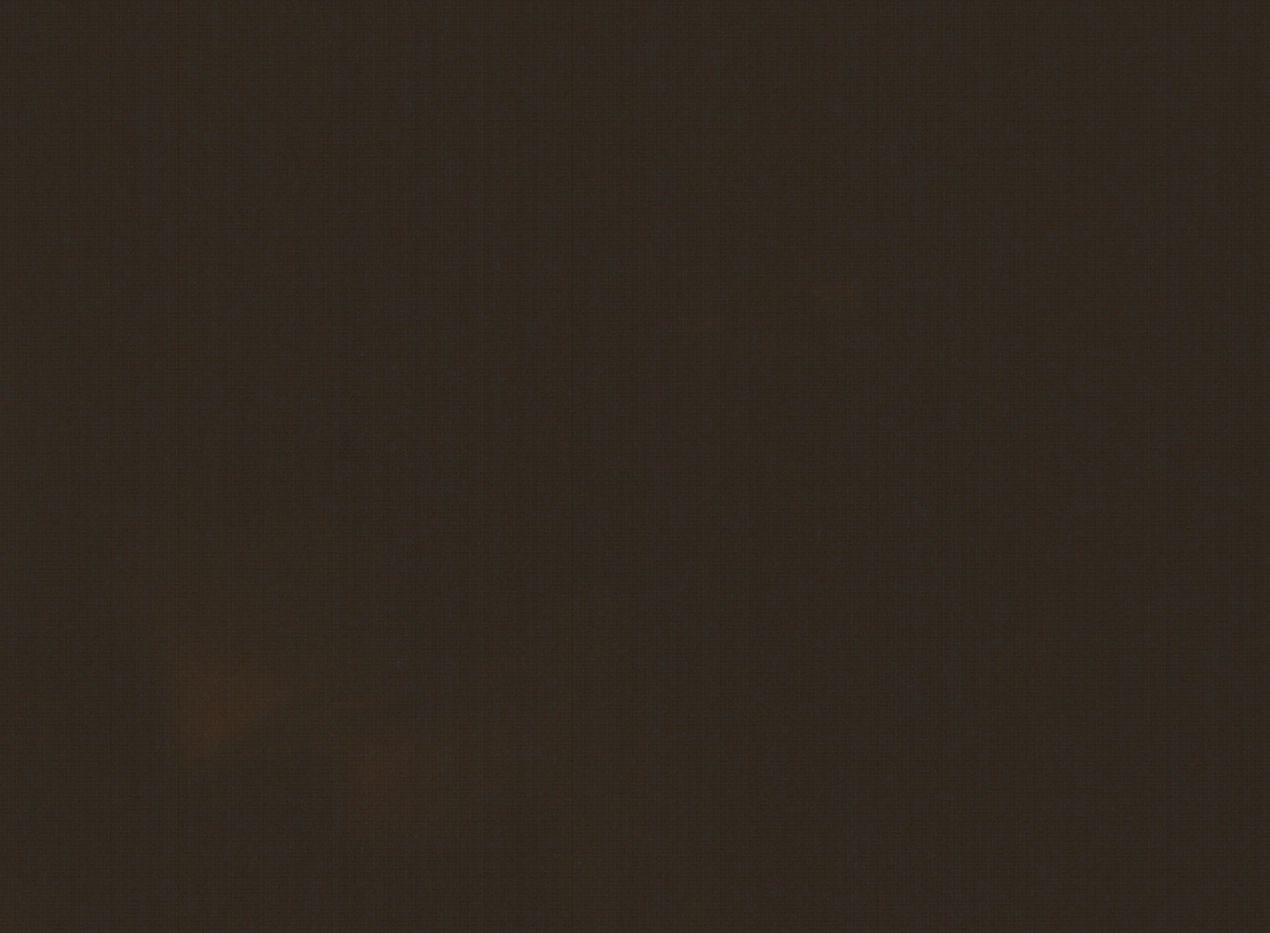

    Here are some sample frames:
ID:	31699Click image for larger version
ID:	31700Click image for larger version
  4. Originally Posted by litemakr View Post
    Here are some sample frames...
    It doesn't look like it's a constant noise at the sensor. Dark frame subtraction won't work.

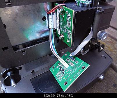

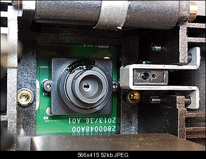

    Feb 2015
    England

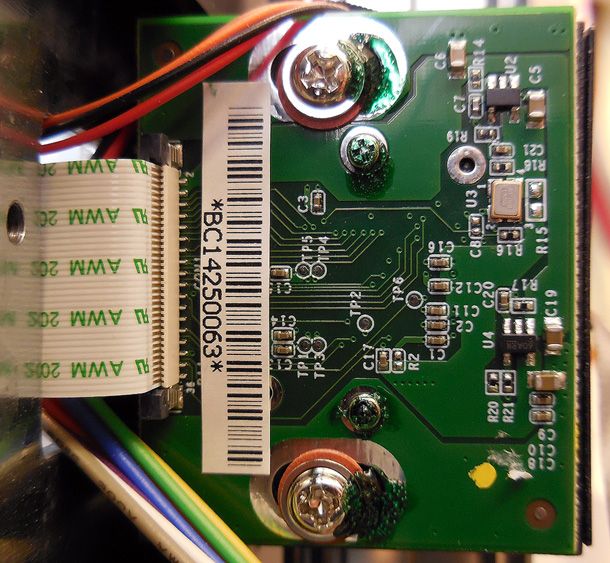

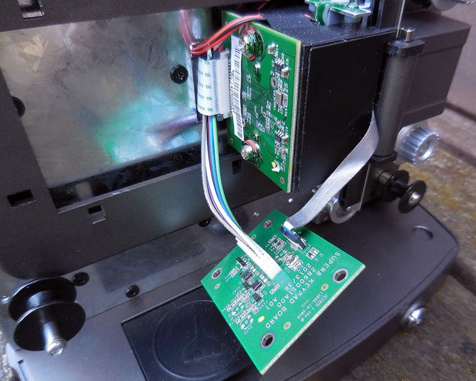

    When I was trying to find out why my scanner had hung, I had a fairly close look at the electronics, but of course it turned out to be a bug in the firmware. I was curious about how it worked and briefly thought about completely replacing the imager, but went no further.
    This shows the boards on the front side of the unit:
    The one hanging down has the pushbuttons and indicator LEDs and also drives the film illumination LED board in the swing-out housing, via the thin flexible cable. There is a preset pot which probably sets the LED brightness. Increasing backlight brightness whilst decreasing electronic gain would be one option to reduce noise, but we don't seem to have a proper gain control.
    The other board has the imager:
    Back of imager board. Not much going on here - the flat flex ribbon cable connects to the main board in the back half of the unit, where the clever stuff is happening.
    That board has an MCU, flash memory, eeprom, stepper motor driver, RS232 transceiver, SD card slot and what looks to be a TI "Digital Media System On Chip" - a very clever device indeed.
    Front of imager:
    It looks like hundreds of other board cameras to me - webcams, machine vision devices, video cameras, etc. The device with a tiny lens on the right is the sprocket detector, presumably just a reflective opto switch.
    There is access to the side by pulling off a thin black plastic cover which is only stuck on. Whilst I was in here, I improved the imager focus whilst watching the scanner software output on a large monitor. I wanted to check whether my improved gate pressure pad had altered things, but I don't recommend trying this - there is a strong paint seal on the lens threads and even after scraping it off I had to use a lot of torque.

  15. Originally Posted by Neutron View Post
    [Attachment 31773 - Click to enlarge]
    [Attachment 31774 - Click to enlarge]
    Front of imager:
    [Attachment 31775 - Click to enlarge]

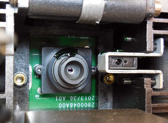

    Could you provide a little more detail about how you adjusted the focus? I feel like mine is slightly on the soft side
    Feb 2015
    England
    It was a bit crude and I can't advise anyone to do it as there are risks of damage at each stage.
    For anyone used to delicate electronic repair and prepared to take all responsibility themselves (and not blame me for any nasty consequences):
    Find a suitable test film which won't matter if it gets damaged, but contains a scene with plenty of well-focused detail. Scan a few frames of this scene now to compare with the results later.
    (From memory): With the scanner power and USB cables disconnected, first remove the grey plastic molding with the 2 LEDs and 3 buttons. There are no screws, just 2 clips at the top, 2 at the left side and 2 at the bottom. Squeezing the top and bottom and levering the left, whilst carefully pulling and wiggling worked for me.
    Be gentle and don't move the molding far once the clips are free, as the board with the buttons and LEDs is on short leads...
    Remove 4 small crosshead screws to release the board and gently leave it hanging from its leads. Be very careful with the grey sleeved thin flat flex leading to the swing-out LED back light box. The other cable and connector are much tougher.
    There is a rectangle of black plastic hiding the lens which is just stuck on with double-sided tape. Prise this off and you will see the side of the lens mount.
    Carefully scrape as much as possible of the green locking paint off the threads of the lens. Collect all scrapings as you don't want them to find their way into the gate or lens.
    Grab the front rotating part of the lens with something. Large pliers would do, but will mark the metal and risk damaging the lens. I used a rubber strap and handle device designed to help with removing jar lids. There are flats on the lens barrel (visible in my Front of Imager photo above), but I had nothing which would fit them. A more competent person could make a useful tool which would make adjustment a lot easier.
    You will have to judge how much torque is reasonable. Any remaining thread locking fluid will make rotation very difficult and there is a risk of twisting the lensholder which may impinge on the imager chip!
    Carefully thread the chosen test film. Make sure the conductors of the hanging board aren't touching any metalwork. Connect the scanner power and USB, switch it on and start the software. Advance the film to ensure it is sitting normally in the gate.
    Use the largest PC monitor you can and maximise the scan software preview window size. Rotate the lens each way to find the best focus, allowing for the slow update of the image.
    As the focal length is so short, if the focus is changed the scan area will also change, so you will see slightly more or less of the frame than before. There is also some risk of moving the image horizontally or vertically.
    Scan the test scene again and compare it with the first one.
    Put it all back together. My lens was very stiff, so I had no thought about using any more thread locking paint!

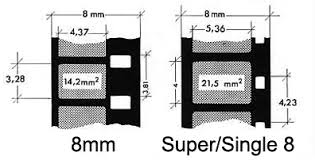

  17. Has anyone tried modifying this machine to work with regular 8??? Is it at all possible???
    ataplow@gmail.com
  18. hi Alan, regular 8 film has different gap spaces between the holes. so you would be replacing the sprockets. which are kinda custom. picture size is also different, the Reflecta would progress forward at the wrong distance every frame.
    basically, it would not work.

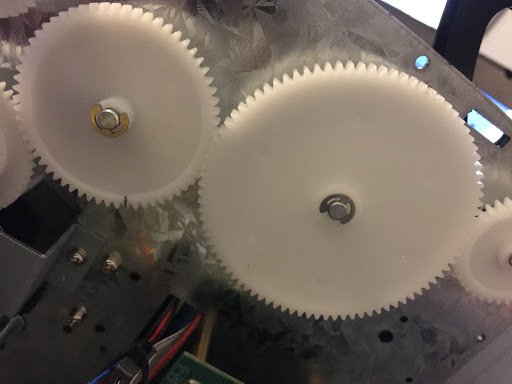

  28. Member
    Oct 2015
    Like PMBen. I'm having the arm drop problem.
    https://www.youtube.com/watch?v=_aoZDc7UH6Q
    Not sure if it's just the normal process of scanning that causes the 'drop' or if it's binding and therefore dropping. Either way, it's making the reflecta worthless to me. Happens pretty quickly (within 45 frames of starting. Mostly less). Happens with or without splices.
    Anyone have this issue and have a fix?

  30. Member
    Oct 2015

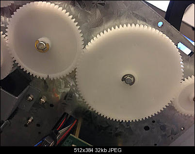

    The arm drop and the fix that is working (for me so far).
    After watching the arm drop (like the video from my post above) for awhile and seeing that if I picked it back up right away and placed it back on the gear that the scanning process would continue without an issue (making me think it wasn't binding and then dropping, instead just dropping) I started to think about how it could be fixed. Bend the arm that holds the gear so it stays locked to the gear? Seems a bit destructive.
    I wider gear would work, as then the arm wouldn't be able to slip past and drop. That may be able to be found and purchased.
    Ultimately though I noticed that the larger gear (picture below) wasn't symmetrical (when sliced down the middle) and that if it was flipped over it would be out and eighth of an inch (or so) more.
    So I flipped it. And now the arm can't make it's way past the gear. The arm no longer drops.Click image for larger version
Name:	Gear Front.jpg
