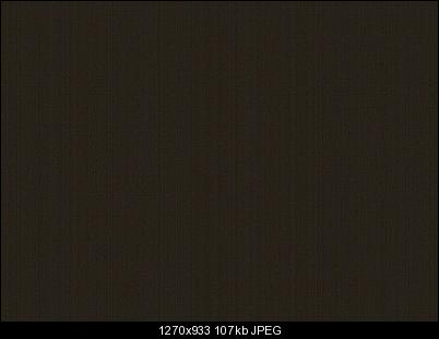

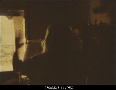

  5. I finally got a film to scan and found a previously unreported problem. The sensor is very noisy. There is pattern of noise across the entire frame which looks like a fine moving grid. It's definitely NOT something on the film because it shows up clearly when the brightness is completely turned down in the cyberview app.
    Here are a couple of frames captured with the brightness turned down which clearly show the problem. Is anyone else having this issue? This is a showstopper for me, it makes the scanner useless.
ID:	30803Click image for larger version

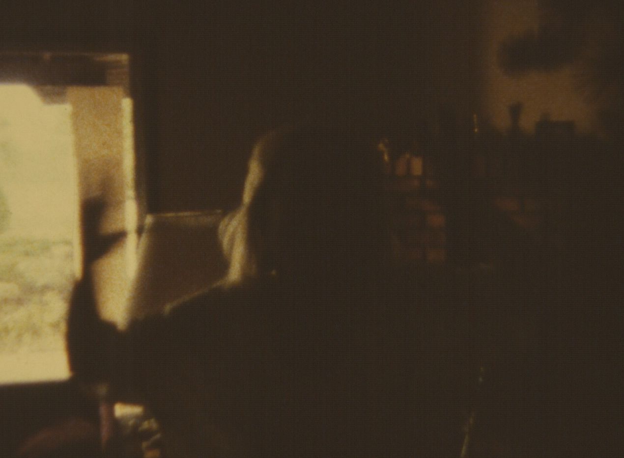

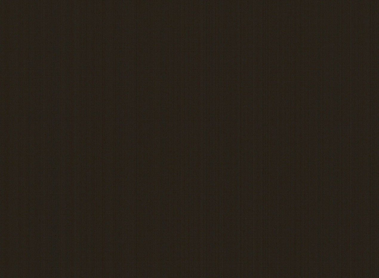

  7. Below is a scanned frame set to brightness 0 and it still has severe noise in the dark areas. I wonder if my scanner is defective because I can't imagine this being acceptable to anyone. Taking this into Vegas and tweaking actually makes it look worse.
  8. Banned
    Oct 2014
    Northern California
    Based on the pattern it looks like a case of lack of cleanliness to me.
  9. Originally Posted by newpball View Post
    It's an electronic pattern which moves, it has nothing to do with the film or the physical surface of the sensor. And it is consistent no matter what film is in the unit. If you saw it in motion it would probably be more clear.
