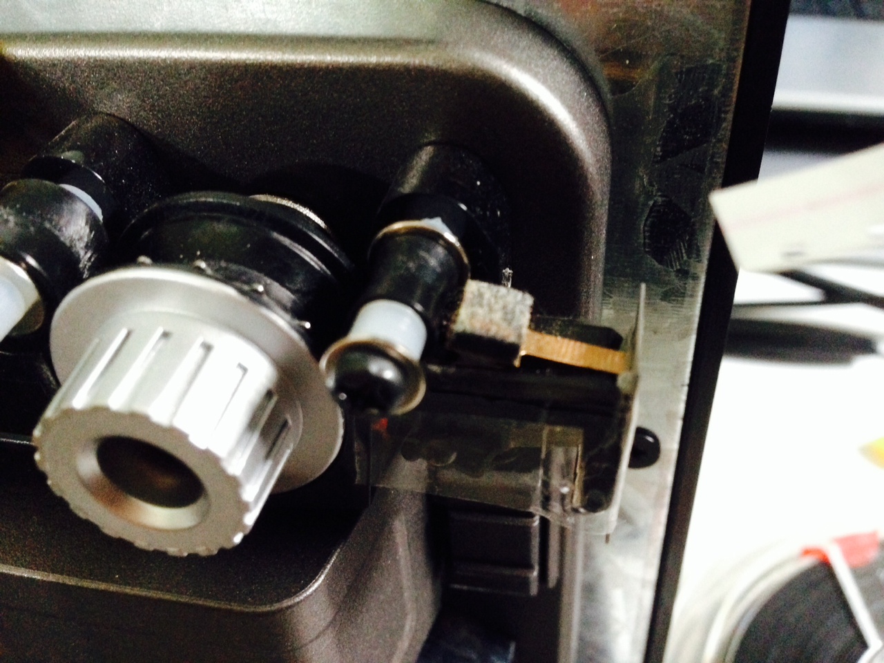

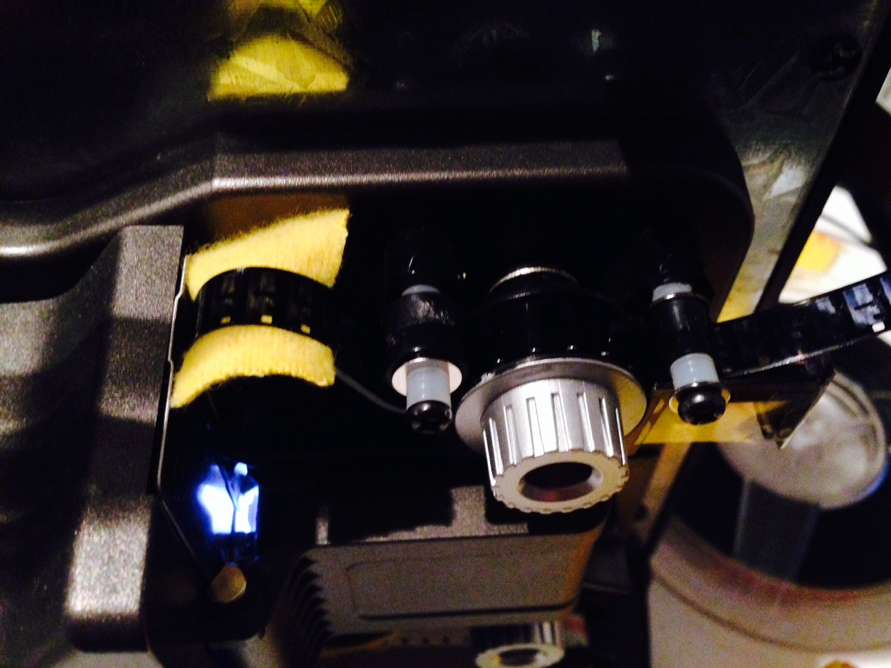

  9. Click image for larger version
ID:	29294Click image for larger version

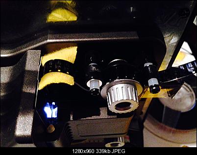

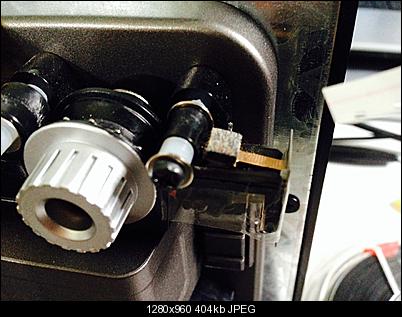

    hi all,
    Here you can see 2 pics of the mods i have made to the top feeder of the Reflecta scanner. These mods are important because most of the scratching/damage occurs in the top part.
    first you need to undo the two black screws and remove the plastic cover from the top feeder section, this is the only way you can put some fabric on the sharp turn that the film makes as it rubs against the abrasive plastic directly. You also need to take the small plastic wheels and file them smooth as they have the plastic injection points on the wheels on the surface that touches the film and the plastic wicks in the plastic wheel guides leave dents in the film. (yes, extraordinarily poor manufacture but true).
    then to avoid the plastic film sensor scratching the film straight down the centre as it feeds, i have used the felt pad spring from a cassette tape housing and it sits above the plastic sensor lug. so the film runs across the felt pad, not the plastic sensor lug. you can see this in the pics on the right.
    i have also made up some spacers and used a small washer to help keep the film guiding nicely. Then its just a matter of being a little more gentle when feeding a film through the scanner.
    (DO NOT try and put the yellow felt on the surface and think you are going to get the plastic housing back on. its just not going to happen. it is extremely tight in there. and you will never successfully feed a film through again. plus you want to replace the yellow felt (a record cleaning cloth cut up!!) every 5 scans or so...so you need access easily...so just leave it off....better )

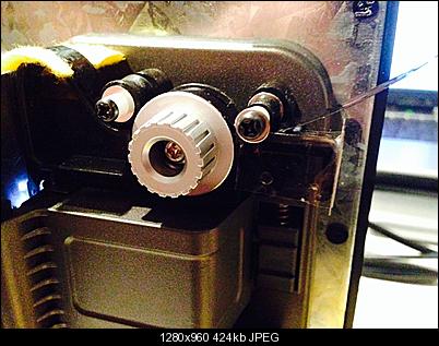

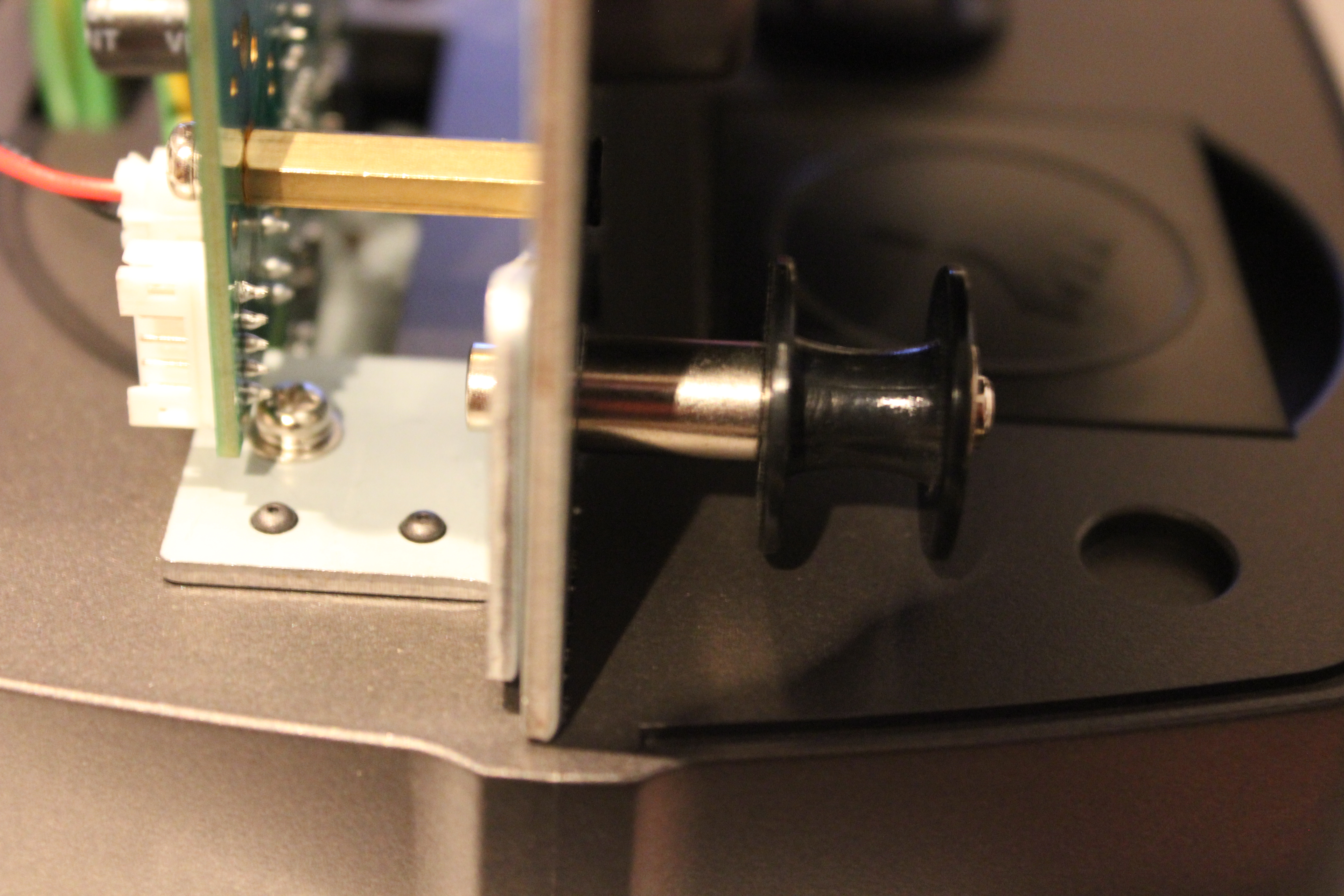

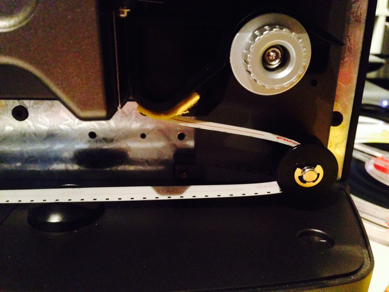

  11. here you can see the mod i made to the bottom area, you need to remove also the two black screws from the bottom feeder cover area and then apply more felt (with blu tack underneath to hold it in place) to the bottom turn so the film again doesnt rub against the raw plastic. then you can skip the bottom sprocket and run the film straight to the lower wheel.
    its important to run the film to the wheel on the right still, instead of going the short way back to the takeup reel. Why? because the film running across and back as it does, acts like a kind of gentle elastic band-kind-of-situation when tightened, so it keeps more constant pressure on the film feeding through the actual scanning lens. the film needs to be tight into the takeup reel, otherwise your scans will look "watery" where each frame floats left or right when being scanned. But its okay to make it tight now, because you have felt and wheels and pads in all the right places. when i say "tight"... i mean, it just needs to be tight enough so that the film does not look like its "sagging" on its run across the bottom of the scanner. if its not sagging loose, then its tight enough. you dont want it too tight otherwise you may actually stretch your film!

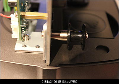

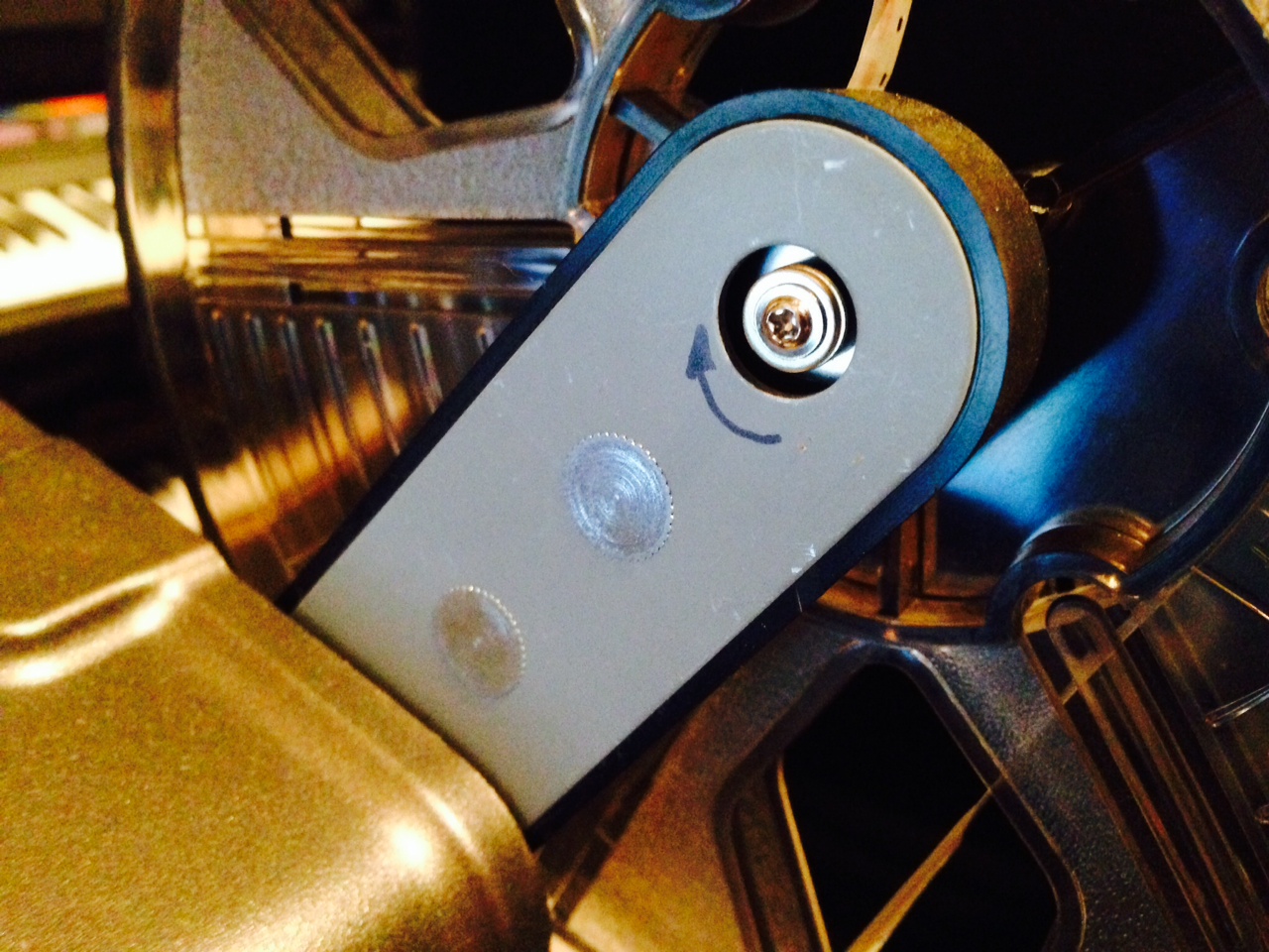

    now, another mod is to be able to manually adjust the strength of the takeup reel clutch. this is important for the reasons above, and easy. just remove the two white stickers from directly behind the reel pins, and the screws that you find adjust the tightness of the "clutch". Here you can see i have marked which way i turn the screw to tighten the takeup reel pull further. I give it a tweak every so often.
    for the reel that the film is being fed from (the right-hand reel)...i have it LOOSE AS A GOOSE. free-spinning. Important. (my unit was shipped with this cranked so hard that the film was shedding from the moment it entered the machine at the first wheel!...completely un-necessary.) And actually the more loose it is being fed, the better the film is lying across my cassette tape felt pad and holding down the plastic sensor lug ...doubly good
    with all of these mods and the software update....all problems are solved....your scans will be smooth, no skipping, no jitter, no film scratching! every scan will be nailed first time.

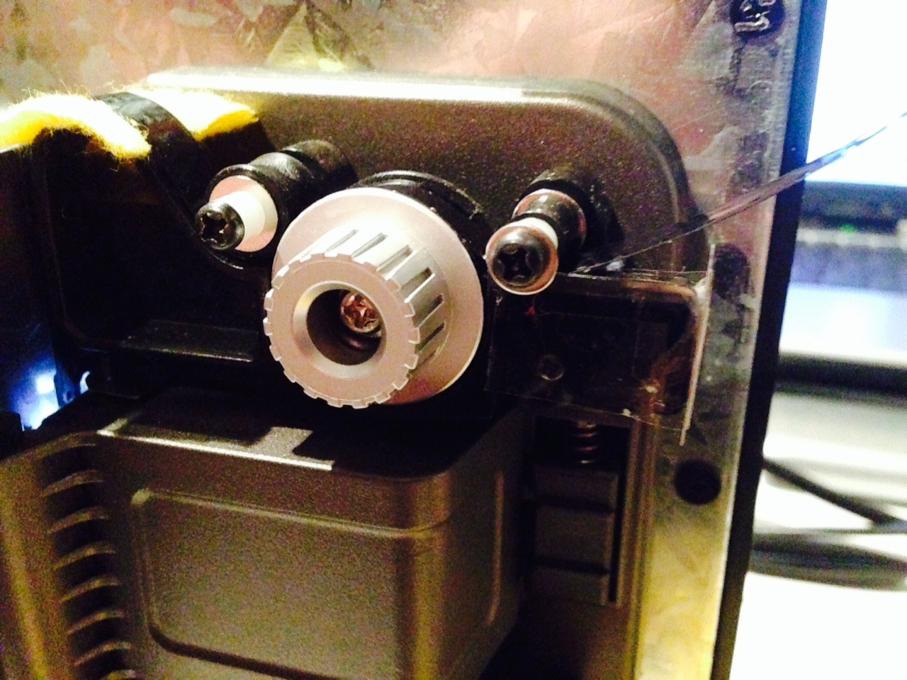

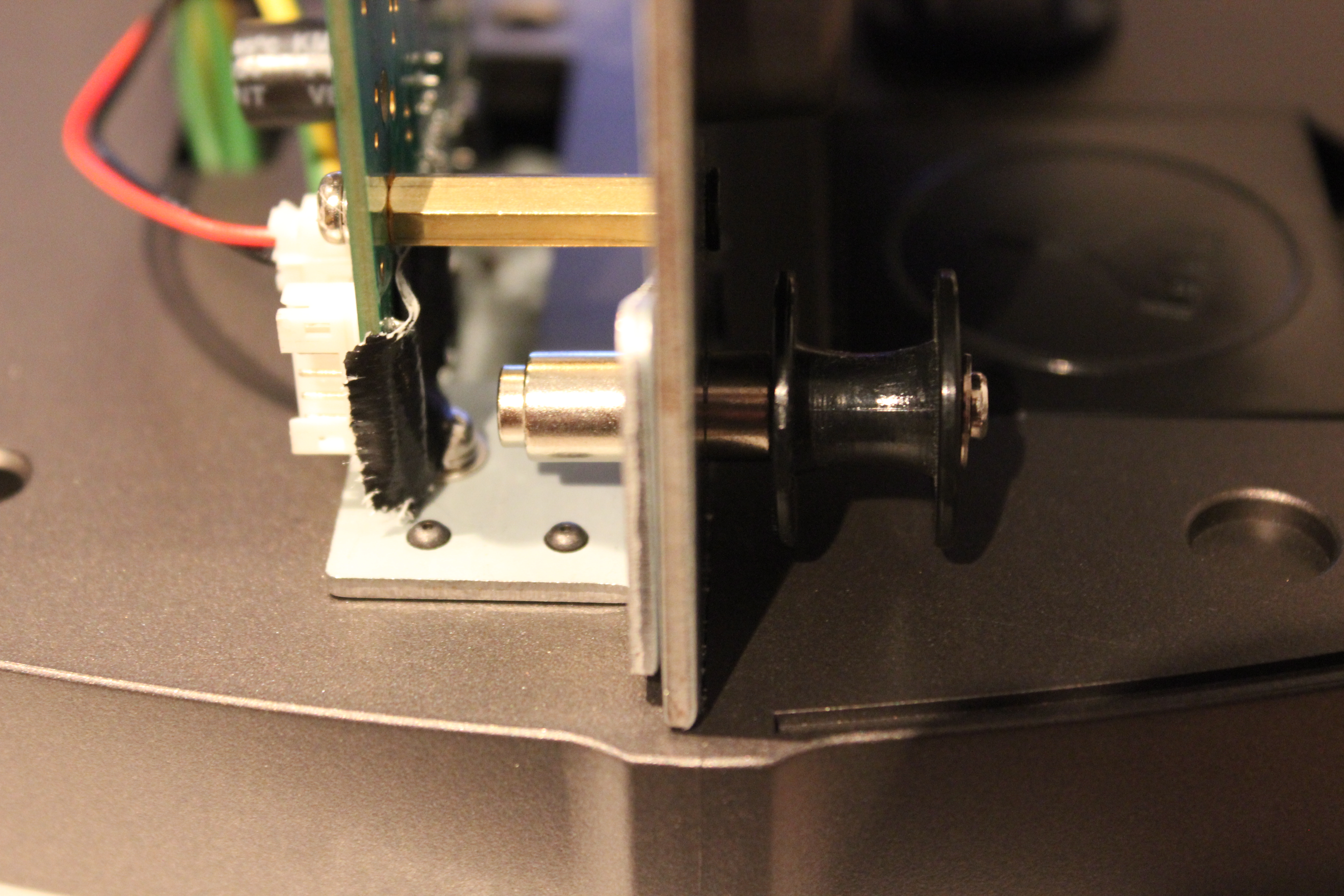

  12. finally here is a better picture showing exactly how the cassette tape housing pad mod is mounted and located. i used half of the actual pad spring to "hover" the felt pad over the plastic lug sensor. So the film now pushes across the soft felt pad, and not directly dragging across the plastic lug as Reflecta shockingly designed originally (underneath the pad in this picture)

  15. VenCain...how did you remove the lower right sprocket? does the whole sprocket pin just unscrew? if you turn hard enough? or is there a clip inside you need to remove?
    if you look closely, the bottom left sprocket is manufactured out of alignment (another fault) and it is too far out, compared with the bottom sprocket on the right. this makes the film run slightly sideways across the bottom, and also makes the film feed crooked into the takeup reel, causing the film to always rub on the side of the takeup reel. the lower left sprocket needs to be reset deeper into the unit to make it in line. i am just wandering how to do this. Because the sprocket pin looks very well stuck in there!

  19. ok my lower sprocket mod has worked well. now the sprocket can slide in and out to adjust its position, so the film threads onto the takeup spool properly. i also put some black tape on the board just in case the post happens to push against it.Click image for larger version
ID:	29407Click image for larger version
