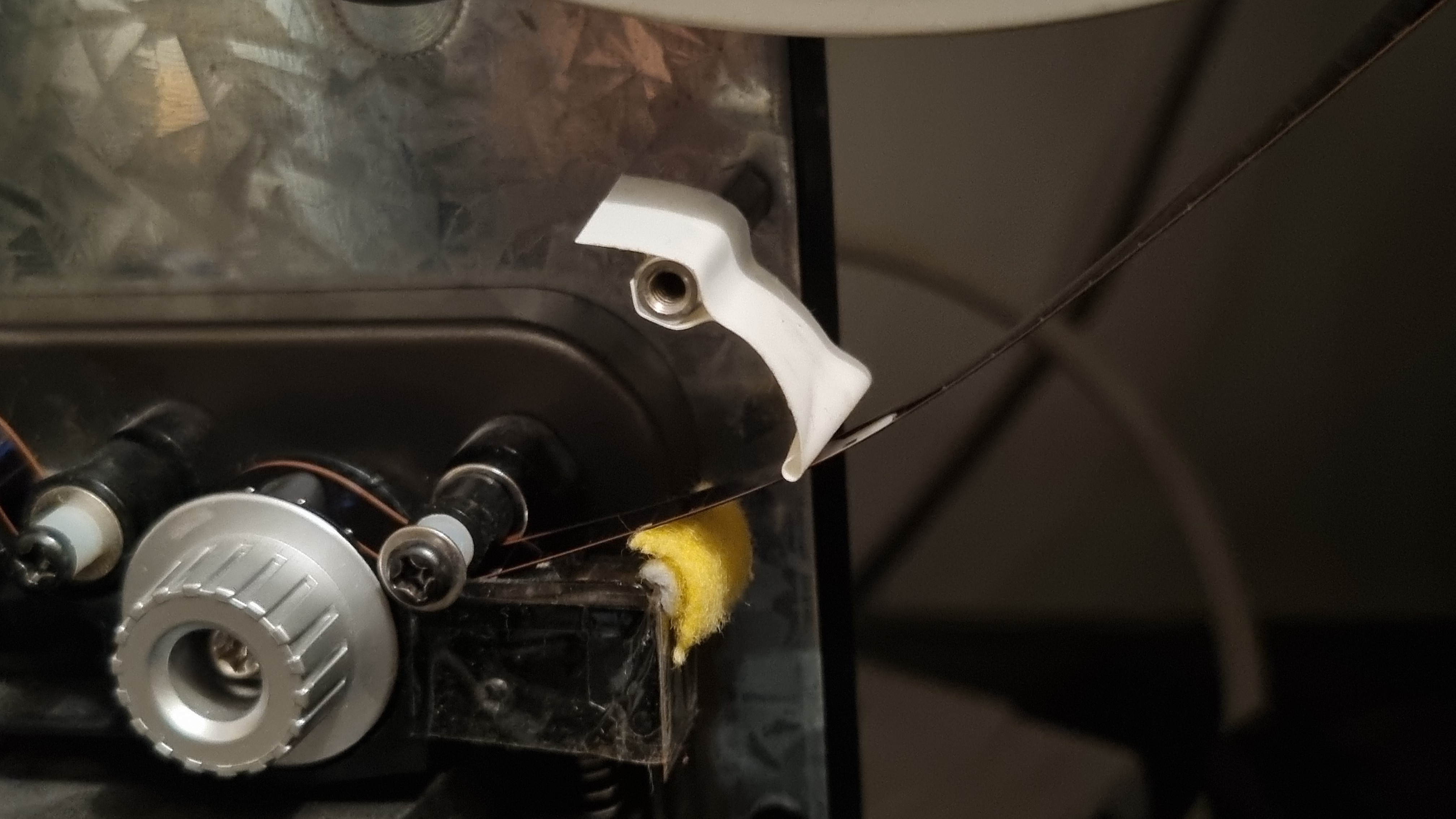

  1. here is a pic of another rudimentary mod i have done. The pitiful quality of the arms is so bad that they sag forward when the film is on , causing the film to feed into the reflecta on a less-than-ideal trajectory. Basically, i used some electrical tape to pull the arm back so the film at least rolls in straight.
    Helps to avoid the "Film Stuck!!" problem again...thanks to smoother uptake of the film.

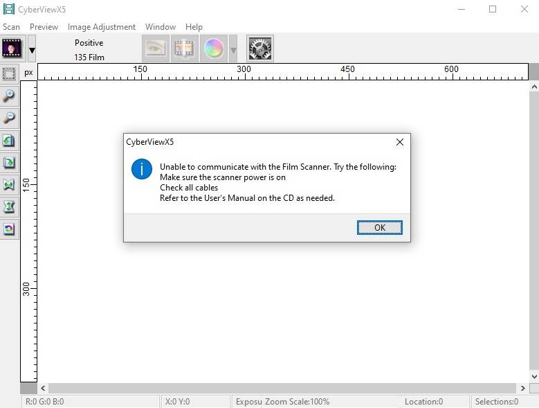

    Hi,

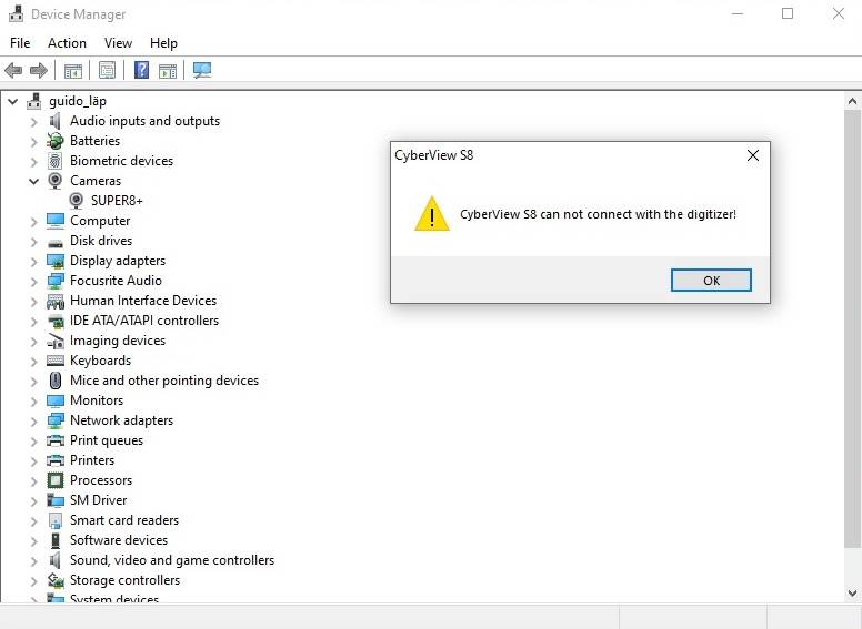

    Does anyone have software/firmware/driver for this device (reflecta Super8+)? Cause manufacturer pulled all the files down and unable to use this device
    Couldnt find on web.archive.org.
    Found installer for: CyberViewX 5.18.12, but it gives "Unable to communicate with the Film Scanner."
    Pic below:
    [Attachment 68631 - Click to enlarge]
    Found installer for: CyberView S8 v1.1.2.14, but it gives "CyberView S8 can not connect with the digitizer!", its visible that windows automatically installed driver "SUPER8+" in device manager.
    Pic below:
    [Attachment 68632 - Click to enlarge]
    Im starting to think if device is defective or some-kind of special driver needed.

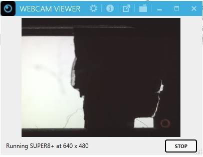

    To verify if device is working, tried program "WebcamViewer" and result below (working):
    [Attachment 68633 - Click to enlarge]
    Tried clean windows 7 install, same behavior
    Jan 2023
    Estonia
    Turned out that needed right software to get Super8+ working, asked reflecta support and they provided the software. Uploading here incase someone needs in future. Thumbs up for reflecta support.

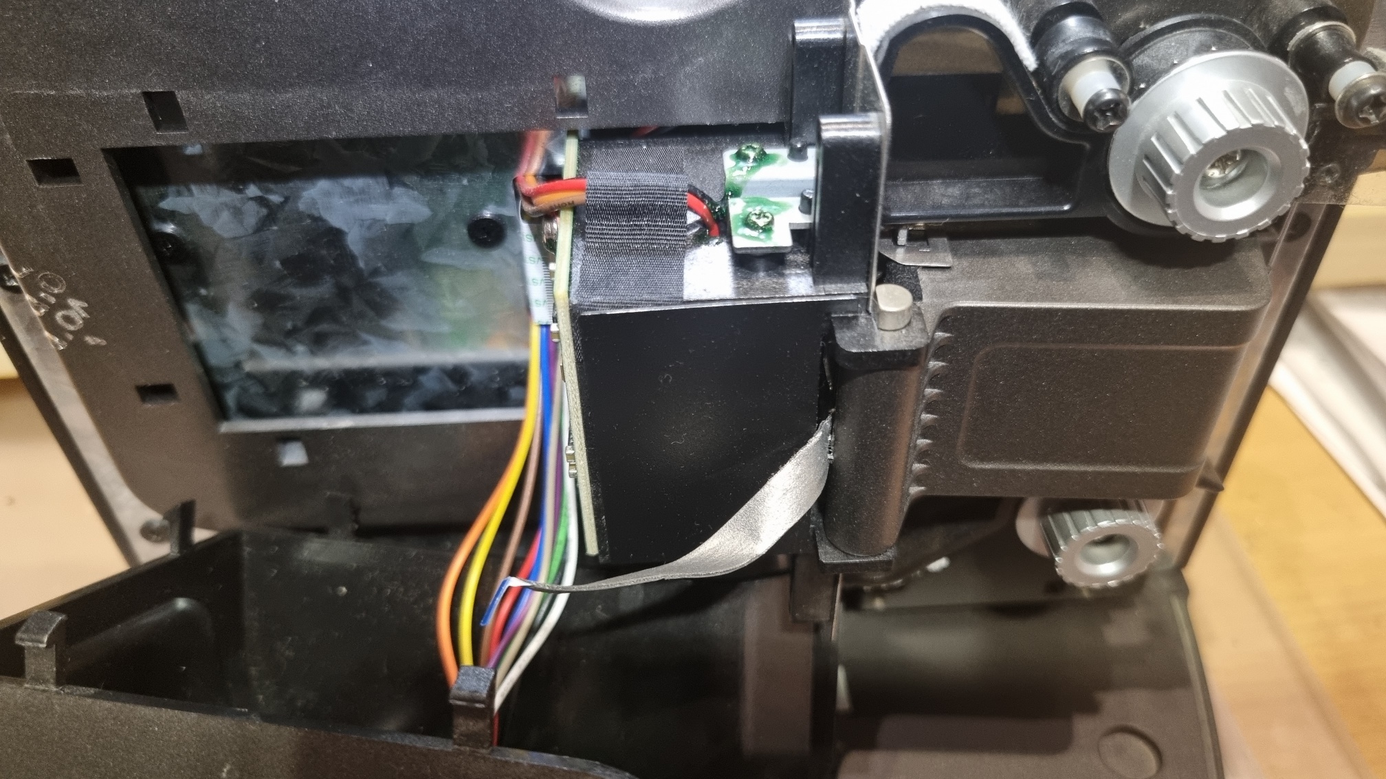

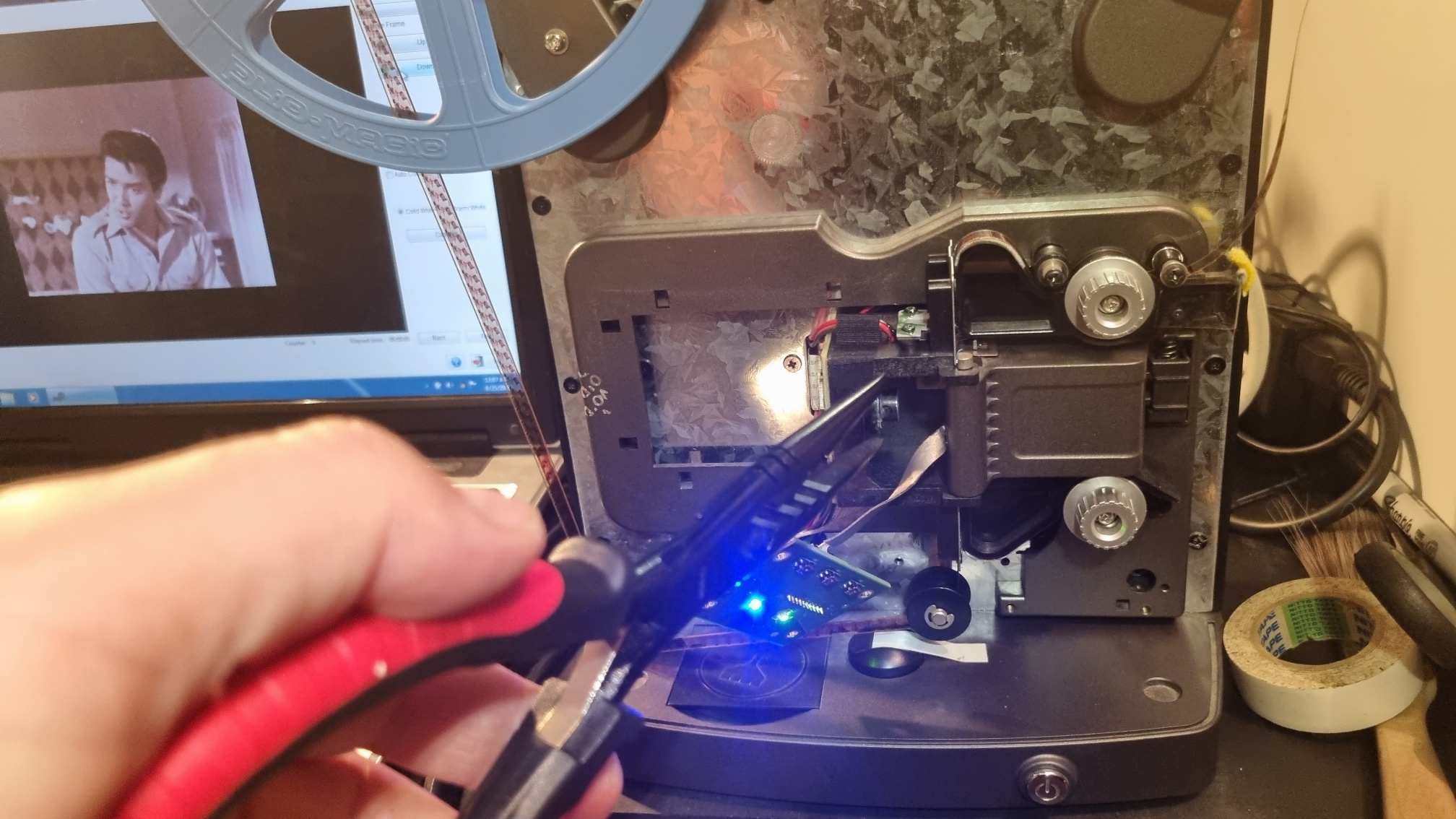

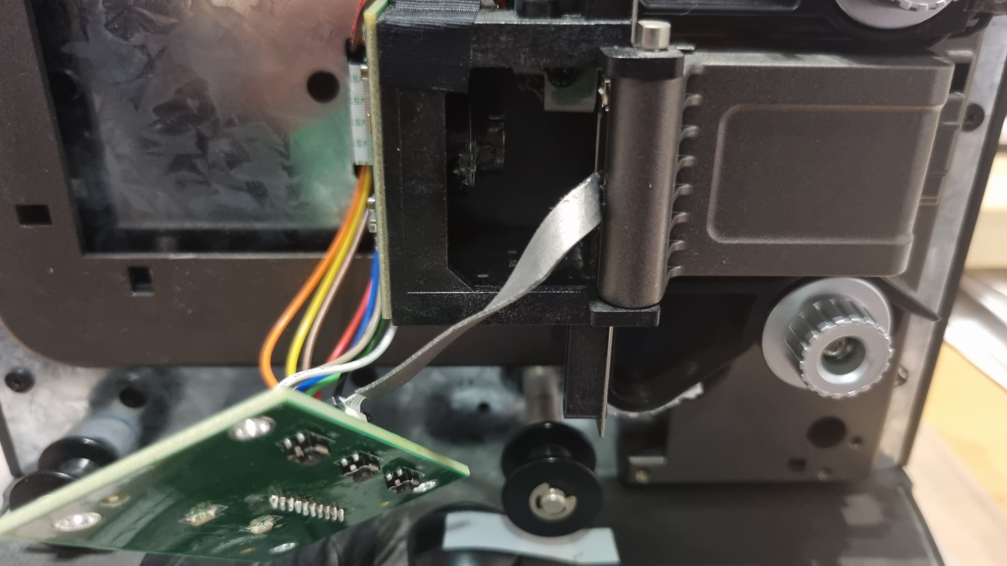

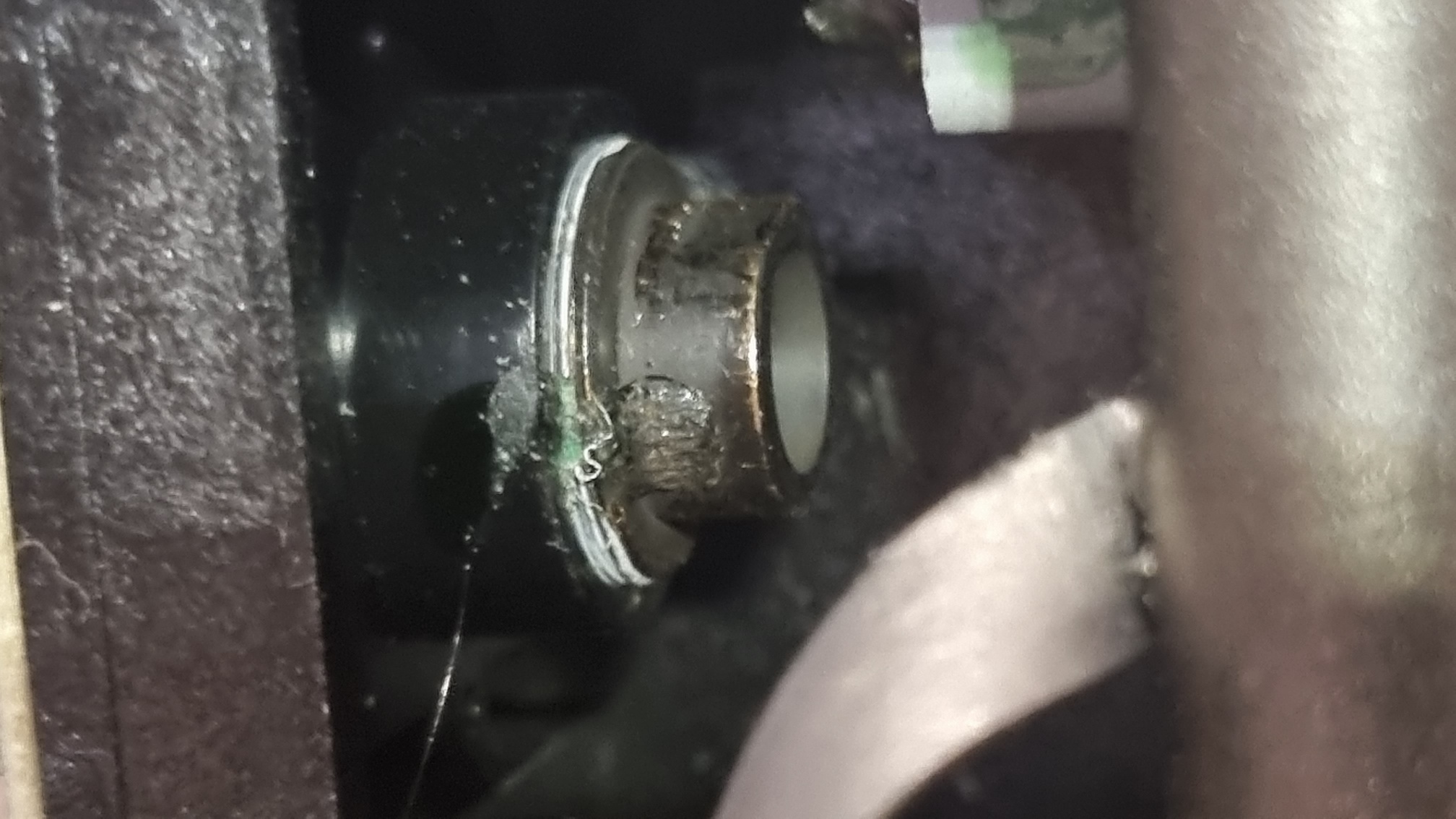

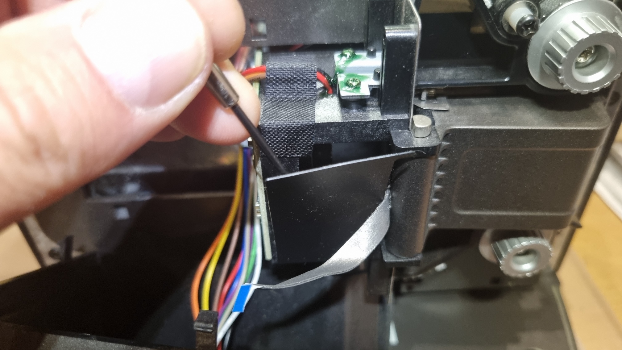

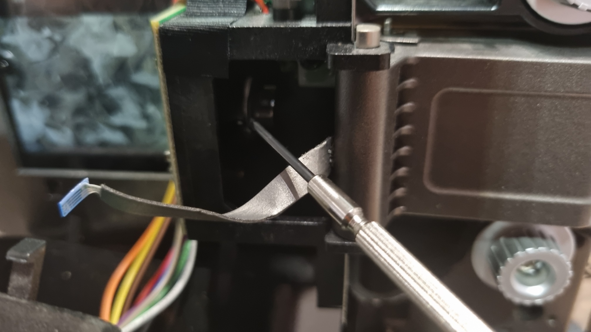

  21. Today i did the focus adjust ment for the Reflecta. Heres some more pics i took as i went....
    [Attachment 68866 - Click to enlarge]
    [Attachment 68867 - Click to enlarge]
    [Attachment 68868 - Click to enlarge]

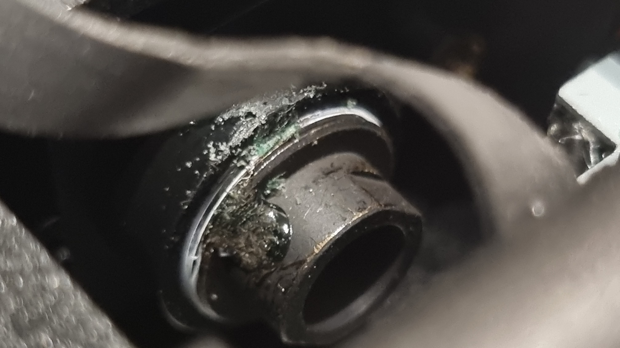

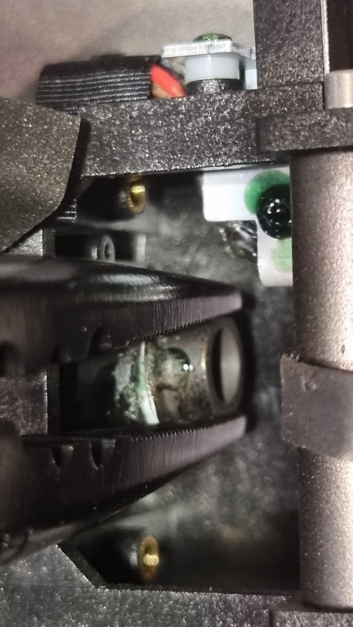

    [Attachment 68869 - Click to enlarge]
    [Attachment 68870 - Click to enlarge]
    [Attachment 68871 - Click to enlarge]
    [Attachment 68872 - Click to enlarge]
    [Attachment 68873 - Click to enlarge]
    [Attachment 68874 - Click to enlarge]
    [Attachment 68875 - Click to enlarge]
    [Attachment 68876 - Click to enlarge]
    [Attachment 68877 - Click to enlarge]
    [Attachment 68878 - Click to enlarge]

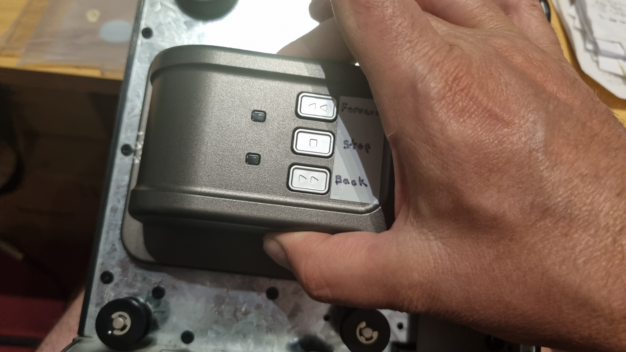

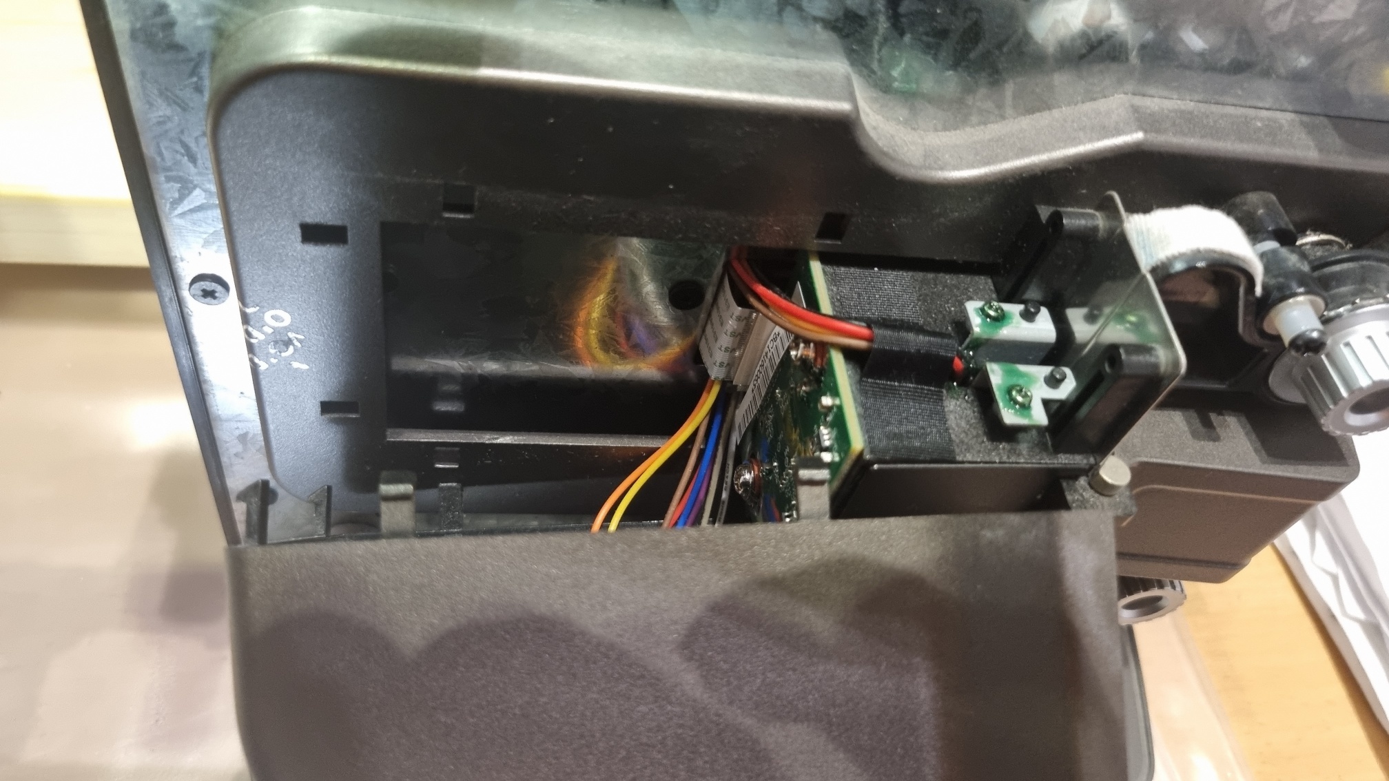

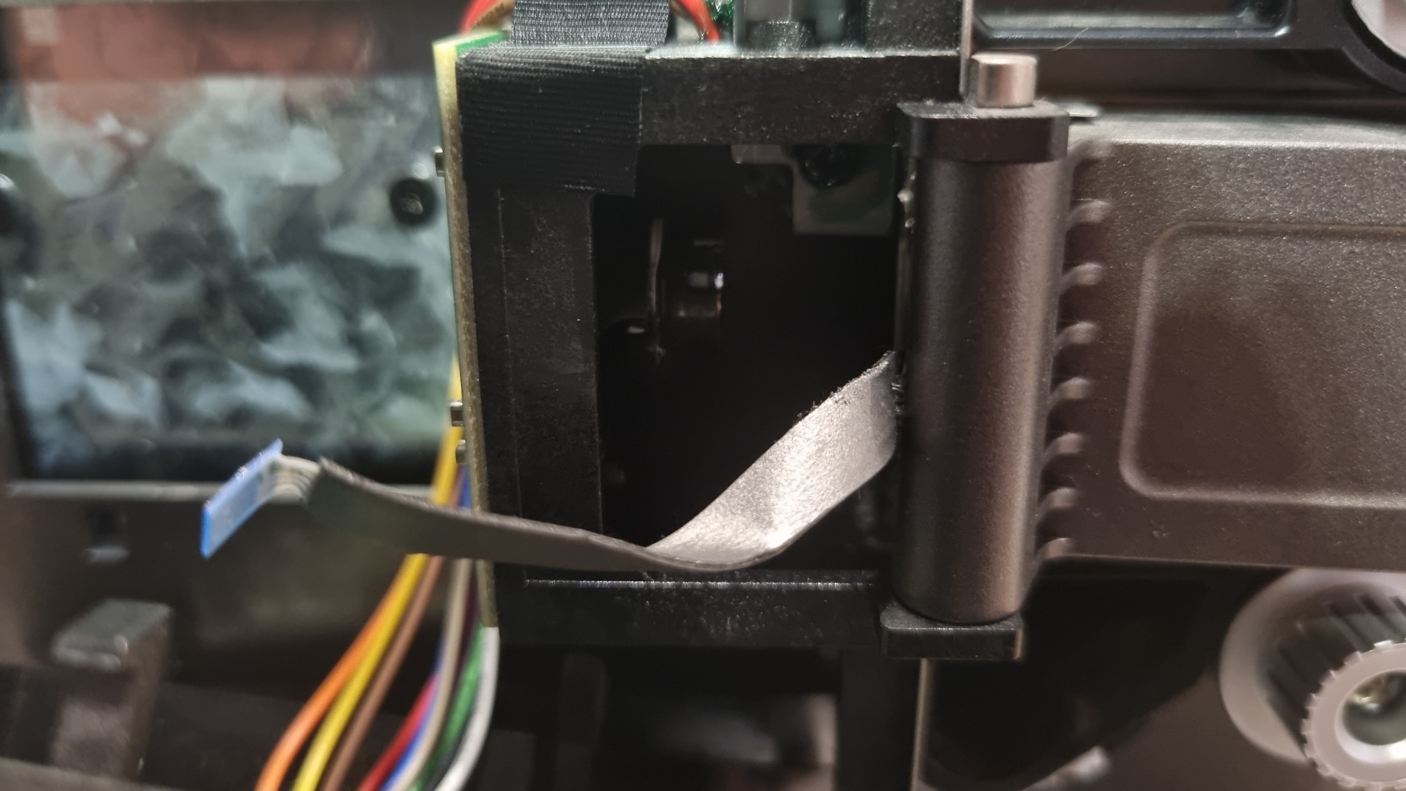

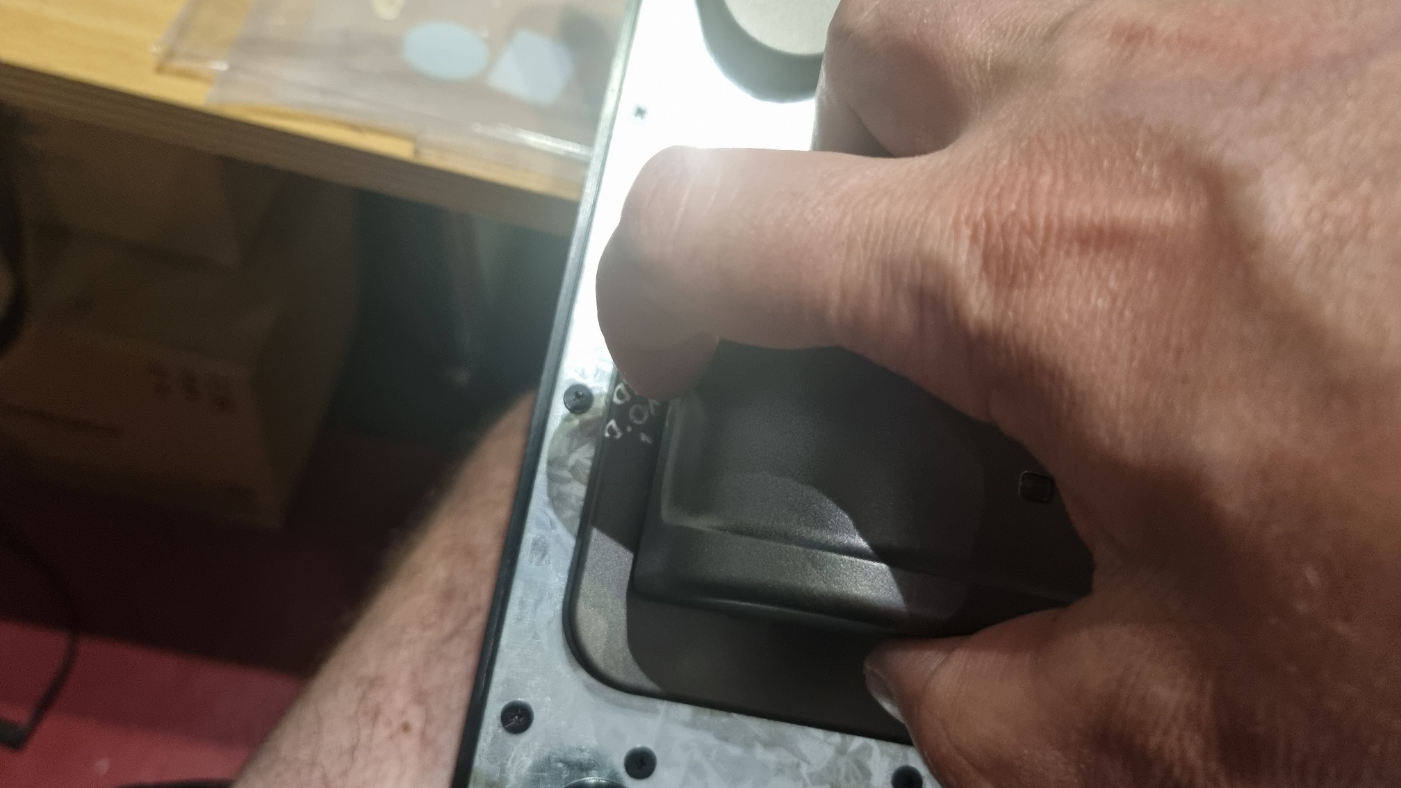

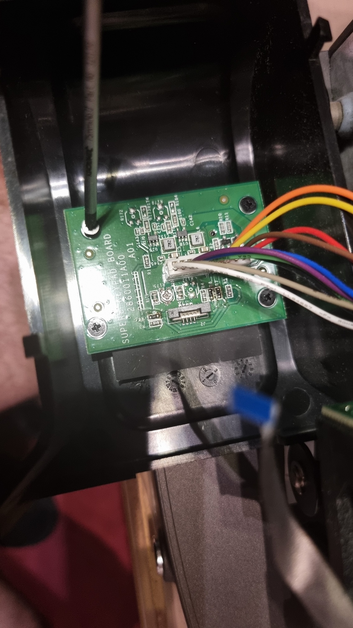

    Use your fingers to squeeze the front button panel off.
    I used long-nosed pliers after scraping away the glue from the lens. It then turned quite easily...only needed to apply a light amount of plier squeeze to get it turning.
    I turned it 3 swings of access allowing turn per focus check...the pliers can only swing so far before hitting the top or bottom of the access area.
    I turned it one way until it looked really out of focus, took about 6 lots of 3 turns. Then i went back to original, and started swinging it the other way.
    Got a good feel for where the "middle ground - best focus" was and it turned out to be about 10-15 deg away from its original spot. So well worth doing.
    Cheers,
    Blackout

  24. Hi here is a new mod i have added...removed one screw, added some electronic standoff pegs on top of each other and a electric tape "spring".
    This is a most important mod. Because the supply reel is heavy, and the jerky "next frame" pull of the motor wildly yanks on the film to advance. And every 4 or 5 frames when this happens i was getting uncentered scanned frames. Now, this electrical tape spring takes up the slack and provides a cushioning effect to the supply of the film so there is less sudden "tug" on it. I have stopped getting jumpy/uncentered frames now.
    here is a pic, and a link to a video of it in action.
    https://youtu.be/yTgtr-iSAEU
    Sadly, Cyberview S8 is the only software that works with Reflecta S8. I tried their X version too...doesnt recognize. Ive tried most other software too.
    I have Cyberview S8 V2.2 working successfully with Windows 11 x64. If you have no joy, many people report that the Mac version works "better". But i am not sure what "better" means exactly...i am almost ready to try it, perhaps it recognizes frames better, no "film is stuckk!!" messages ? if anyone can report what is better about the Mac version exactly that would be useful to know

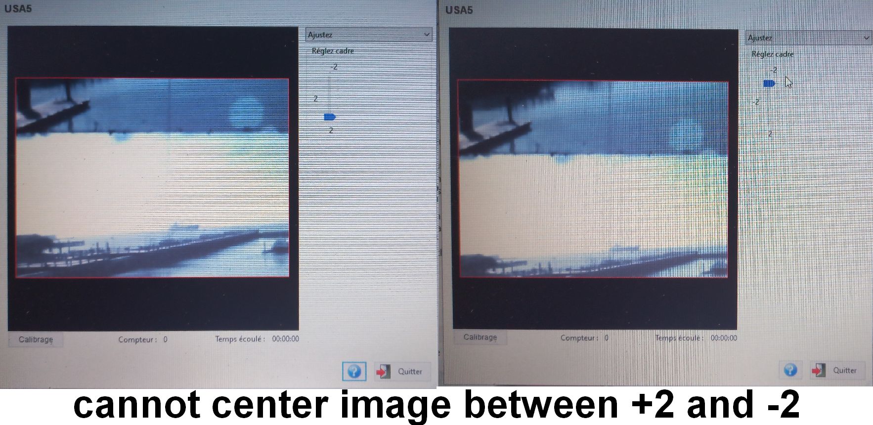

  27. Hi,
    After more than 500,000 frames scanned without problem, it suddenly became impossible to center the imageImage
    [Attachment 88743 - Click to enlarge]
    I use Cyberview V2.2
    Where does it come from?
    Regards
