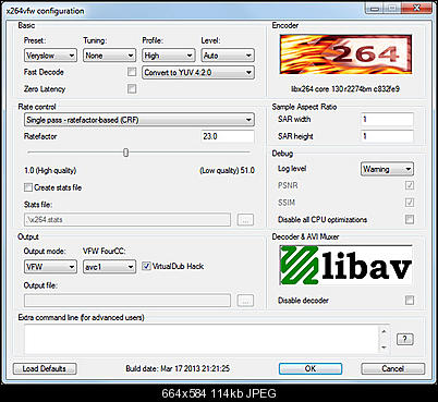

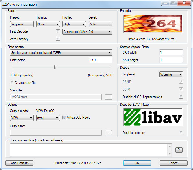

  4. These are my current settings:
  5. Banned
    Freedonia
    Really, does it take an Einstein to figure out that
    Preset: Veryslow
    just might be part of the problem here?
  6. After posting the picture I saw this setting as well .
  7. Try the veryfast preset and see what you think.
